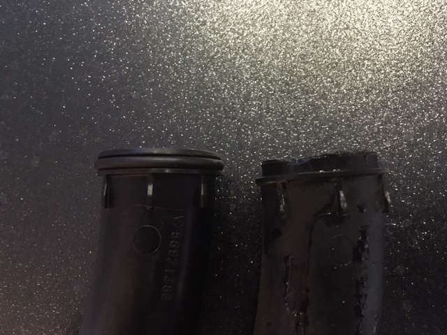

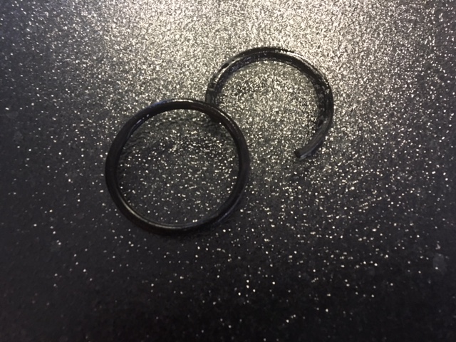

I put this in a different thread but perhaps this might be a better place for it since it came up during the thermostat housing replacement.
______________
Hi everyone!
Finally finished up the job. it was the water tube leaking. Supposedly it was replaced when the water pump was done in April, but I seriously doubt that.
I've attached a couple of pictures. The o-ring and plastic remains are what I fished out of the water pump housing and you can see the end of the tube is destroyed. No wonder it was leaking.
A couple of thoughts:
I would never do the thermostat housing again without unbolting the intake manifold. It is six bolts and it is no problem removing the passenger wheel to get at the lower bolt. It took me a ratchet and a pipe for leverage to remove it, but I suspect it was gorilla'd on the last time it was off. I know most how-to's don't mention this so user's choice I guess.
Removing the manifold gives unrestricted access to the water tube and if nothing else, it was easier for me to unbolt the manifold than to try and put that stupid clip on blind (I missed it last time BYW - it felt seated but when I had the manifold unbolted it was nowhere near the grooves.)
When replacing the water tube I put lube on the entire space of the water pump housing and a little bit on the o-ring. I recommend silicone grease - I know I use it for SCUBA diving because vaseline etc. can break down the o-rings, but there are mixed notions out there.
A racquetball ball is the perfect size for the thermostat side of the water tube. It fits in the opening and gives a large area to push on with the right hand while I used my left hand to guide and twist the water pump side of the tube.
I used Pentosin Pentofrost NF coolant. I used BMW the first time through, but after it leaked out I removed the rest and was unwilling to drive the hour and a half to get more. The Pentosin lists Mini compatibility and it's blue. It is also available in store at O'Reilly 90 second from my house. Works for me.
To drain the system I removed the radiator hose on the coolant tank side and use a shop vac to drain the system. Unscrewing the bleeder screw made it drain more quickly, even with the cap off the coolant tank.
I ended up draining my system 5 times. Originally I drained it and filled it with water and Prestone flush - someone had used Dex-Cool in it. I then flushed it with water twice. I finally filled it with 50/50 BMW - which promptly leaked right out. After replacing the water tube I flushed it with water again finally filled it with 50/50 Pentosin.
Careful of brittle stuff - when removing the manifold the PVC hose snapped - totally brittle. I simply snaked a hose inside the old one and used shrink wrap to seal it. It is not perfect but I don't really have $80 for the hose and I am not in the mood to remove the manifold to replace it when it gets here. So far no CEL and it is basically a breather so it should be fine.
The hose clamps are a major PITA but if you are using regular pliers the easiest way to get a grip is to use the serrated "bottle cap opener" part of the blades keeps the clamps from slipping. Still one of the most annoying parts of the job for me - YMMV.
When replacing the manifold screw all the nuts on finger tight then torque to 11 ft/lbs. I don't have a torque wrench so I went with snug. Same thing for the thermostat housing bolts.
Finally, I can't remember what the actual procedure is, but I forgot to unscrew the bleeder screw the first time I filled the system and it won't fill properly, at least it won't for me. Unscrewing that bleeder screw while turning on the heat etc. allowed it to fill quickly and fully without major air in the system.
Thanks everyone for the help - the hardest thing is doing it the first time when you are unsure exactly what to unclip and unbolt. The thermostat housing itself is easy peasy lemon squeezy and the manifold is even easier IMHO.
BTW, the Bremman housing is EXACTLY like the stock unit that came off the car, so my advice is save your money and buy after market rather than OEM.
Attached Thumbnails roll call, have you replaced your thermostat housing .-img_0223-1.jpg   roll call, have you replaced your thermostat housing .-img_0222-1.jpg
______________
Hi everyone!
I got the Bremmen version as well, because ECS Tuning offered free shipping for that one part, but Rock Auto also has one (although it just went out of stock): http://www.rockauto.com/en/moreinfo....441103&jsn=305
Yeah, my coolant pipe also snapped off at the o-ring, so I simply got one off of eBay: http://www.ebay.com/itm/NEW-Mini-Coo...JWkMXQ&vxp=mtr

Originally Posted by perryinva
I replaced my tstat myself a few months ago and didn't change the water tube or water pump. If I replace the water pump, and remove the intake manifold, is it possible to replace the water tube without removal of the tstat? ( in other words, if the water tube inserts in to the back side of the pump, does pump removal allow enough room to back the tube out of the tstat?). Or is it possible to just loosen the tstat enough to get the water pipe out when removing the water pump?
Thanks!
The tube itself is really not a big deal to replace and seeing so many failures I think it is cheap insurance if you are in there anyway. Especially after my experience.
I tried to just loosening the thermostat housing - it was more trouble than it was worth and in the end it was just easier to remove it and reinstall it.
I can't answer the question about the water pump for sure - it looks like the engine side of the housing is separate from the pump side so it may be that simply removing the pump isn't enough to get the tube out.
