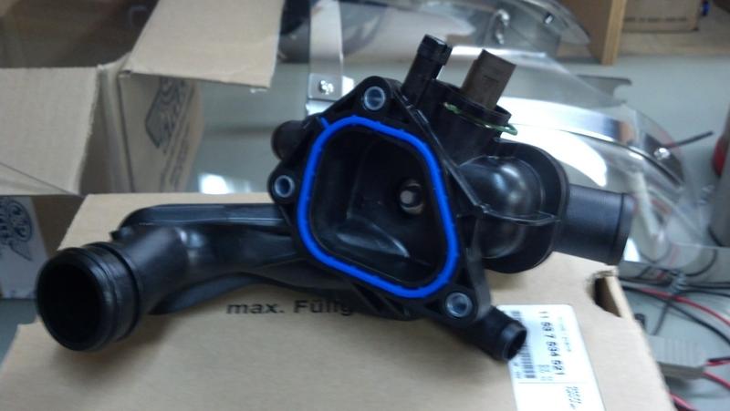

Good morning RGLARRY,
My leaking issue was rather sudden. And sadly my water pump and thermostat housing went at the very same time. When I pulled off my thermostat housing I noticed that coolant was barley seeping from the temp sensor. Not sure how long that was going on for. Then I noticed that coolant was pooling on top of the transmission.
You are one of the lucky ones to have had it last that long. My housing was leaking from the rear (near where it mates to the water pump return tube [back side of motor]) on a seam where the two halves are glued together.
If there is no significant leaking/drops/pooling I would say you are okay but be ready. It escalates quickly.
