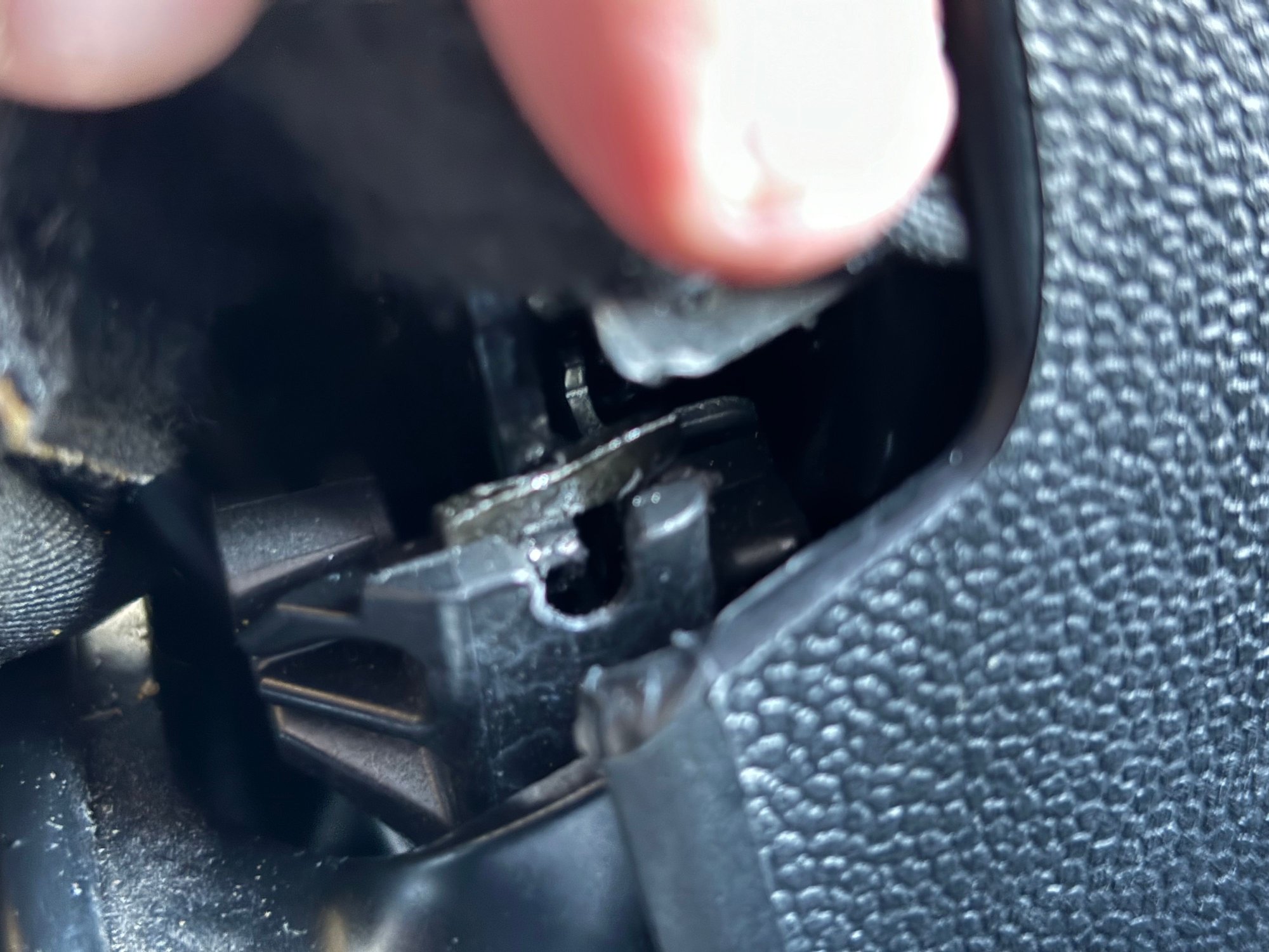

Ok Im reviving a super old thread but I found a different solution from what people have possibly due to my mini being a 2014.
At the bottom right side of the passenger seat there is a gear looking thingy with its hooked de-attached. I was able to pry it back into place by pushing the hook back up. This was all done without removing the seat, only had to remove the back seat cover but that was easy as mine had zippers.
Posting the pictures below for future generations. Hopefully they arent lost

Old Apr 28, 2025 | 10:10 PM
windturbo's Avatar
windturbo
Joined: Apr 2025
Thank you! It saved me alot of time. Thank you
