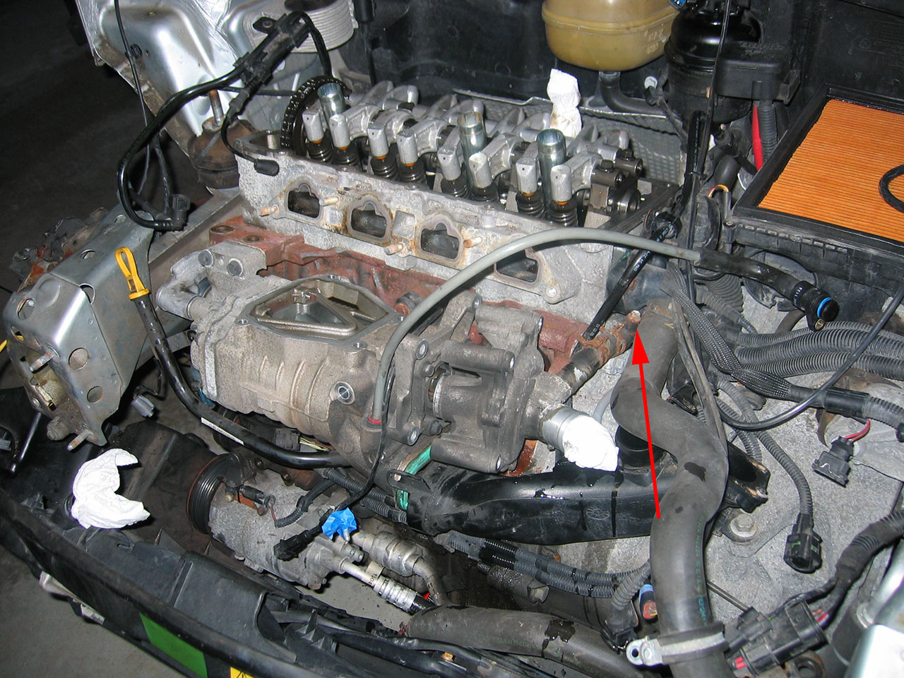

I know about the plastic vent screw on the top radiator hose, but I read in another DIY that there is a second vent screw behind the intercooler that also must be loosen to release the air. Does someone have a photo of this mysterious vent screw? I can't seem to find it.

Its in front of the thermostat.

wow. thank you so much for the pics. Do you guys normally bleed this vent screw as well as the one on the top radiator hose?
