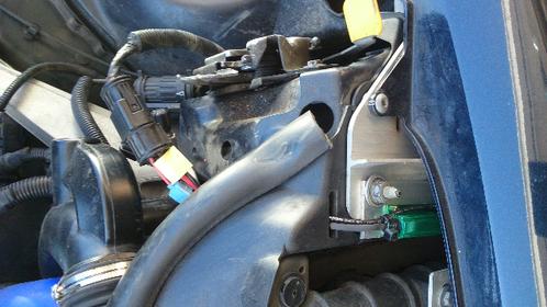

Old Feb 9, 2015 | 12:09 PM
  #1191
elchilo4ever's Avatar
elchilo4ever
Joined: Mar 2014
Posts: 141
From: Las Vegas NV
That's The Place I Install My Resistor.
