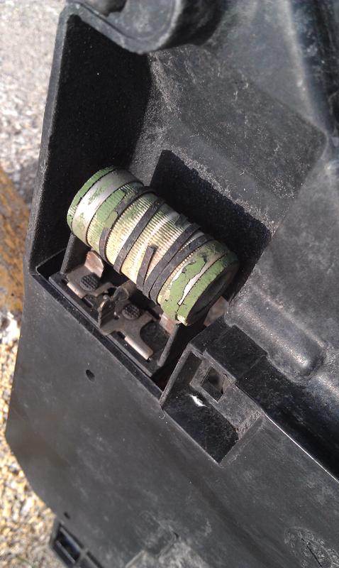

Old Apr 11, 2012 | 09:55 AM
  #642
SimTechDJ's Avatar
SimTechDJ
Joined: Nov 2011
Posts: 219
From: Chicago, Illinois
Just replaced mine... pretty quick and easy actually!
