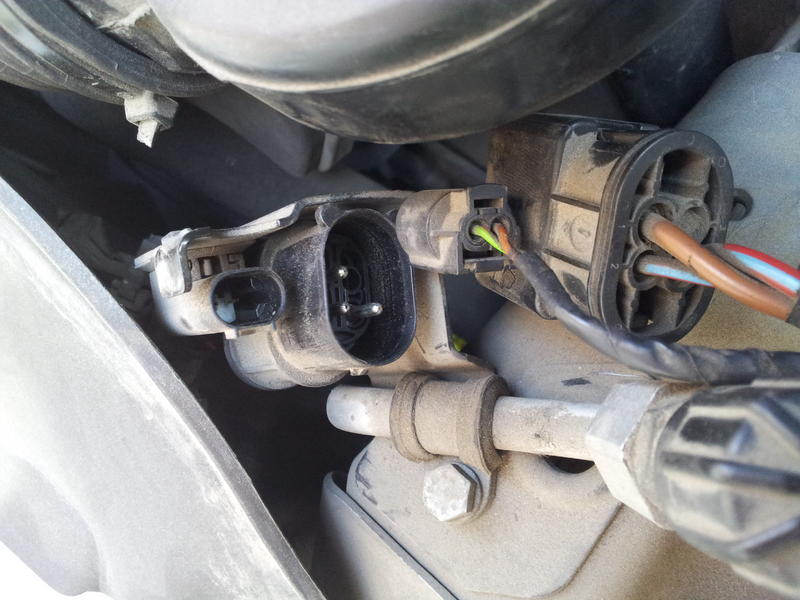

Hello everyone...
My fan is kinda different in that it has two connectors, one small (two pin) and a bigger one (three pins)
See attached picture.
Do you know what is the small connector for?
I still have the first stage problem going on, but I wanted to do some troubleshooting with a voltimeter, but I'm not able to get any readings from the big connector even tough I have a perfectly working 2nd stage at 112 degrees.
Thanks!
Rayanmx

IIRC, the early MINIs (pre 2/2003) have 2 connectors -- the large 3-wire one to the fan and
the small 2-wire one to the relay in the fan housing.
The later ones use a relay in the fuse box under the hood to switch it and have just the one
3-wire connector.
3-wire connector.
Thanks Cristo!
After posting I figured it out when I applied voltage to the two pin connector and I heard the relay click...
Cheers!

We have wired in our Resistor kit on the two plug fans and it works great also. You just have to trace the wires and make sure you get it wired in like the above photo.
