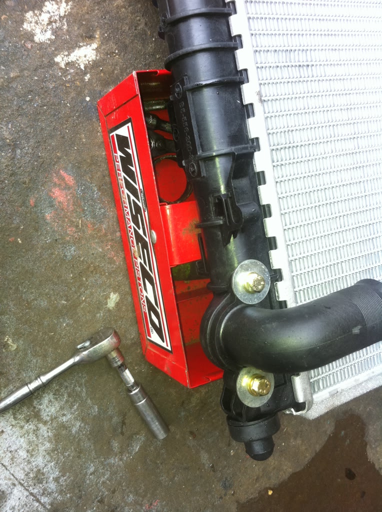

The new resistor came today, I checked the input to the existing resistor & there's power in but not out, hoping to get the new one wired in on Sarturday morning.
No water loss in over a week, however the heaters have been constantly on full!
Done hydrocarbon test - came back negative - phew! Whilst there I noticed the radiator cap seal wasn't the best so I fitted a new one yesterday as a precaution.
Fingers crossed!
Aaron.

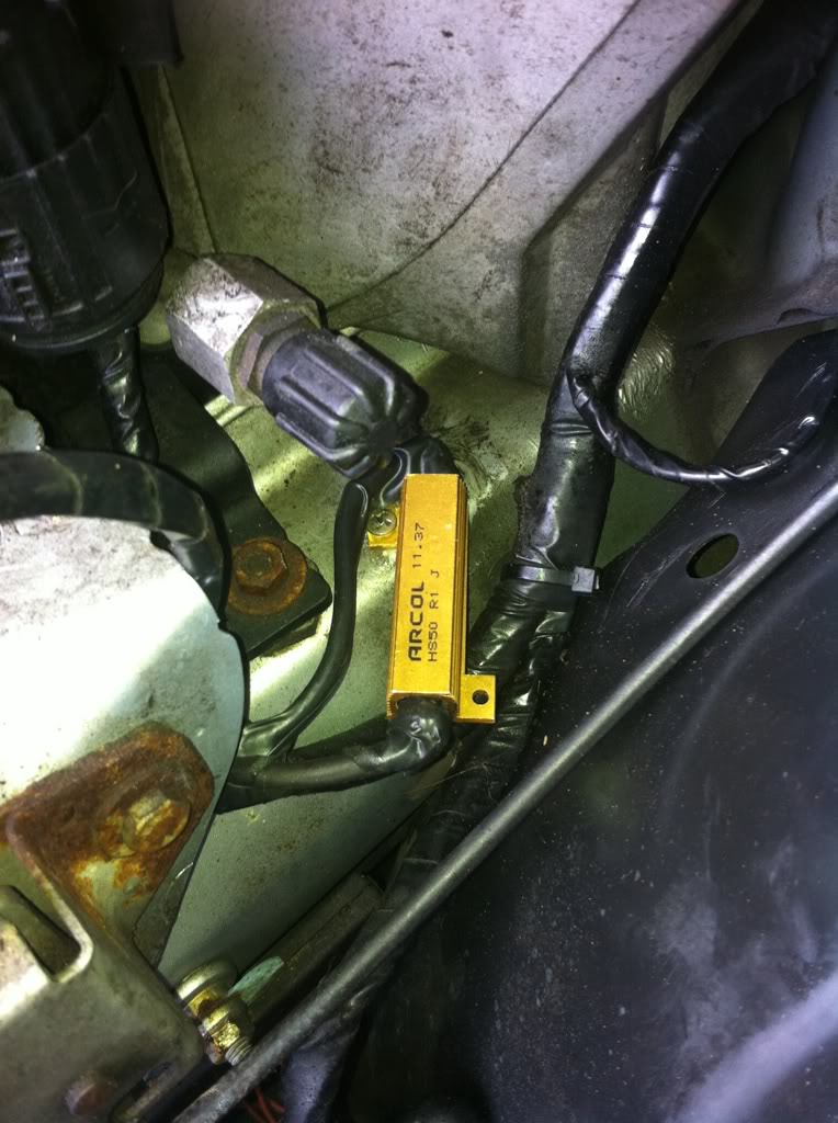

sooo... simply put, If I need to fix my stage 1 fan that isn't turning on, I get the rockauto part.. and install? No worrying about a resistor to unsoldier and soldier back on? And they carry the fans for the 2002 R53's?
Thanks!
Whew...read the ENTIRE thing. I'm shopping online now for the best price + shipping for the resistor. Thought my AC clutch was dead too, turns out the relay was kinda popped out of the socket, odd, but yay, AC. Low speed is definitely dead, nothing with AC on and did the wire test, nothing there either (high worked).
I don't have a soldering iron, and while I could buy one, it's something I'd probably never use again, or not for a very long time.
I saw mentions of other ways to get everything connected (shrink tubing, wire terminal connectors, etc), what's the best way w/o soldering or chopping up the wire harness, and is it recommended to do this fix before the plug (engine side) or after the plug (fan side). Planning on making a mount and bolting it to the rad support.

http://www.radioshack.com/product/in...ductId=2103510
Verify that it matches the gauge of wire you're using and can handle the current.
Haven't done the mod, so not sure whether engine side or plug side is what you want. Hopefully someone else chimes in...
Careful with mounting to the rad support - are you talking about the plastic frame that it sits in? Probably not a good location considering how hot the resistor gets. Something aluminum or metal would be better and help dissipate the heat.
gknorr, thank you! That's very helpful information! I think I'll do the mod on the fan side, that way it keeps the car side in tact. And if I ever have to replace the fan, it can all come out together.
Those connectors look perfect, I've worked with them before. I'll source some shrink tubing as well, keep it all water proof.

This weekend I replaced the radiator, thermostat & housing, flushed the system & wired in the resisitor.
Result... I now have no loss of coolant along with stage 1 & 2 fans and a happy girlfriend!
Rather than splice into the loom I just cut out the old resistor and wired direct to the tabs.
I didnt like the tacky plastic flange on the bottom of the radiator & was going to machine one from stainless and weld an outlet on but thought this was overkill. So I simply increased the pressure area of the bolt across the flange by using pan washers as the last rad hadn't split, just the plastic flange had warped - this is such a poor design.
This shows where I mounted the resistor using only one screw to minimise damage, I also left as much of the resistor suspended in air as possible to avoid dissipating heat into the body, the resistor is not touching the loom as it appears to in the photo.
The wires were then taped and tie wrapped to the existing fan loom for an almost factory look.
