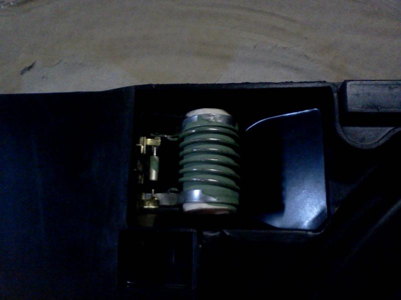

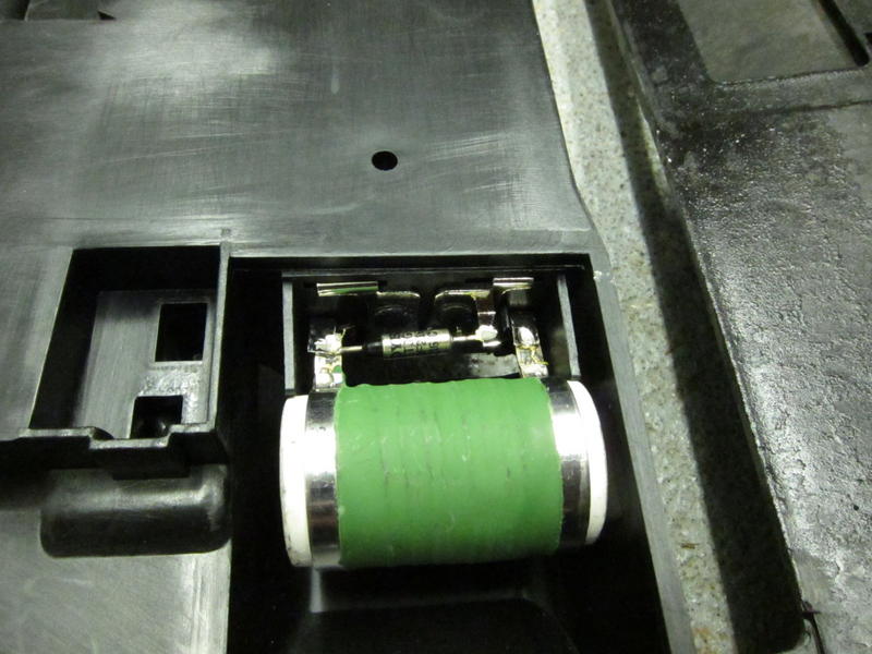

i just want to update on my earlier post.
I received the dorman #620902 fan and it has indeed 2 connectors for my 2002.
The resistor look a bit different from the tyc above and it look much more thicker. Hopefully it will last.
The installation was quite easy, but i spend alot of time removing the bumper because most of the bolt were rusted.
I couldn't remove 2 of the bolt underneath the bumper, it looks like the clip broke, so the bolt were turning itself with the clip. I had to cut to slide the bumper off.
Also the bottom left and right philips screw were seized so i just snapped off. I also broke the two bolts that adjust the bumper height and forward.
Tomorrow, i will drill the broken bolts and see if i can refit them with another bolt. Otherwise I won't be able to adjust my bumper height.
see pic of the dorman resistor

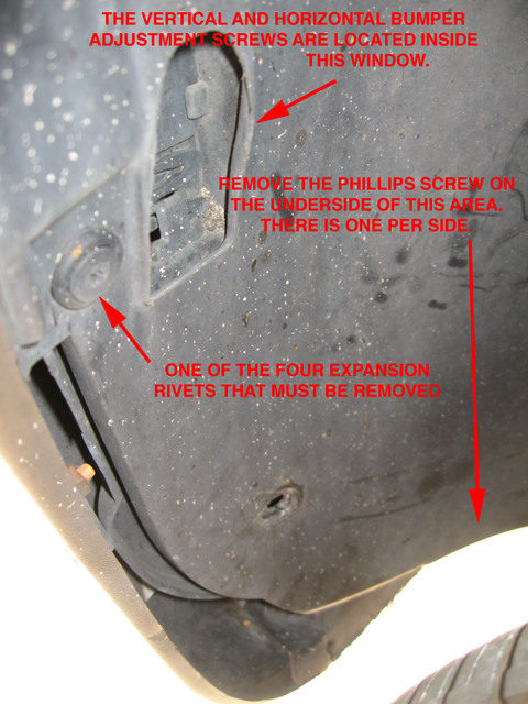

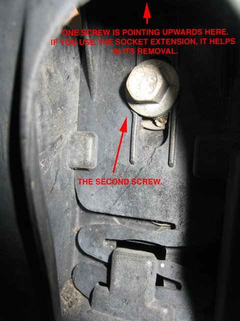

well the plastic piece that has the spring thing is to adjust the height.
But i found out that we do not need to remove them...otherwise we would need to readjust the height.
i dont know why in the other diy thread, the person remove them.
see the picture of that post.
especially that bolt on the top which he said is pointing upward and need an extention to remove it, i dont know why he ask to remove it. i dont see any adjustment. On the second pics, he said that we can adjust horizontally. i dont see how??
Now we're talking. Dorman is clearly thinking.
Anyone see any other brands with a beefed up resister?
Thanks for the picture.
Rich
Rich
The vertical screw is for attachment of bumper skin, not adjustment (contrary to the service mode diy write up). If you read a few posts in the thread below the diy guide to service mode, you will see a post by someone else, who is also in agreement on the adjustment issue.
