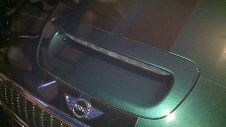

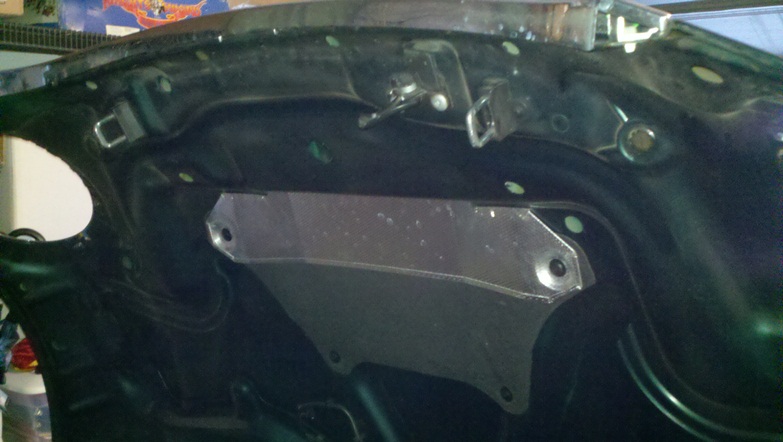

Ok guys...picked up the Clubby today... The dealer installed a new scoop and the heat shield free of charge. I will try and post a picture shortly...

Here are the pics...

Yikes...how many miles since you added the heat shield? The reason I ask is that I have a friend who had the heat shield put on and he has done over 30k with no warpage...

Those of you who've gone in for service, are they adding a heat shield as part of the "repair"?
I've been calling different dealerships to find out if they'll add the part, none of them could answer. I also couldn't find any reference to it on realoem, so I'm not sure if I should purchase one from WMW, or hope they include it during service.

Here in Vancouver, I was told that they are automatically adding the shield with every warranteed scoop replacement. It could be a dealership descision vs MINI directive though. Not sure.

They added the heatshield on mine when I took it in for service back in May. I was told that that is part of the warranty service.

I had mine in just this past week for replacement of the warping hood scoop. In my case, I went in armed with the part number for the OEM heat shield (51 48 2 183 986), and requested that it be installed when the scoop was replaced. They have allegedly installed the heat shield under warranty, but I'm out of town at the moment (my dad picked up the car for me), so I haven't laid eyes on the work yet.

Agreed. Specifically request that your dealer also install the OEM heat shield (P/N 51 48 2 183 986) as part of the warranty work.
