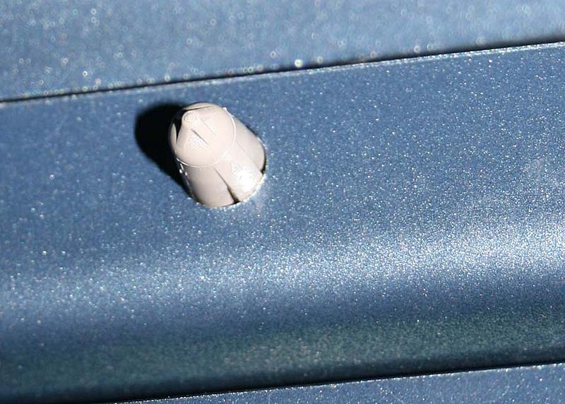

Well I am not sure if this is something but I have a theory based on what I saw on my car. I was going to take my scoop off just to take a look at removing some of the grill and when I went to pinch the little plastic clip to release it my scoop poped up a little once the sides were in enough for it to move up. That fastner is in the middle exactly the place where my dip is starting form. It seems is was creating quite a pull down on the scoop. Could the scoop not be getting hot enough for the pull of gravity to warp it but rather just getting a little soft and this center fastner pulling it down in the middle. This would explain why the dips seems to be in the middle vs the left side where the hot part of the turbo is and possible different clips were pulling more than others causing some scoops to dip while other are fine. I left mine not pushed in to the point where it locks in place and pulls the scoop down. I will see if this stops any more dipping. So for now hurry up and wait.
Attached Thumbnails 2009 scoop melting???-big-picture.jpg   2009 scoop melting???-detail-picture.jpg

Mine is dipping - started after 3 months of ownership. I released the center snap as described by SaltnPepa and the dipping decreased somewhat. I will still need a replacement and I will go with a carbon fiber and pay the difference. Then the decision will be to paint the carbon fiber (I know heresy) or leave it natural on my dark silver MCS.

Originally Posted by SaltNPepa
WFIW I talked to my SA advisor about the "Melting Issue" He said MINI has had 3 revisions of the scoop with change in plastics and the addtion of the holes in part of the grill. He has not see any of the updated scoops come back for replacmet but they have not been around for that long. He said one time replacement from MINI. As to cutting the extra parts out "any mods could affect warranty". I can't see anything on my car but if I run my hand along the gap I think I can feel a little dip but it could have been that way from day 1 since I did not feel it till now.
He's right - the parts have been redesigned, but to be honest, the cost of a CF one versus a new primed one, sent to our local body shop to get paint matched, is about the same - feel free to request one in its place, it's a bolt on mod and should last a long time, add some cf bling-age, resist heat, and avoid paint mismatching, etc.
