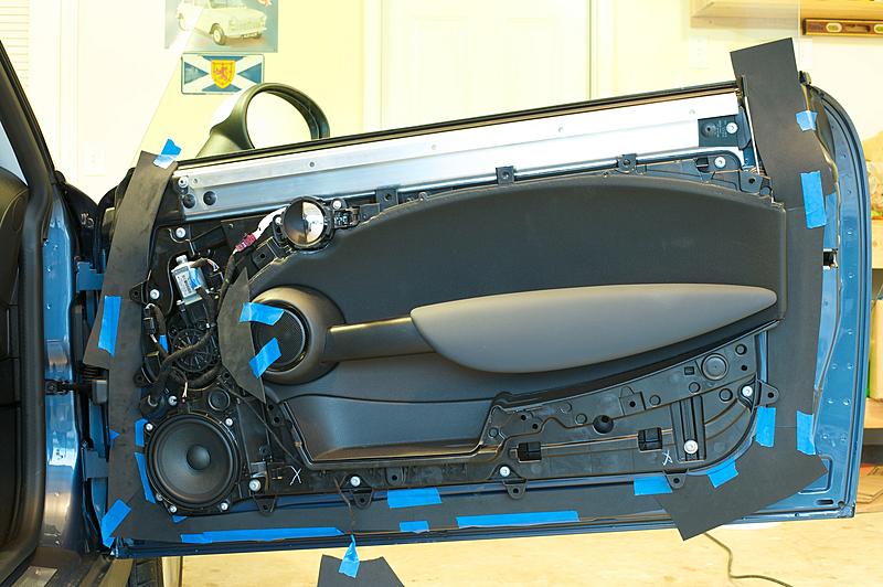

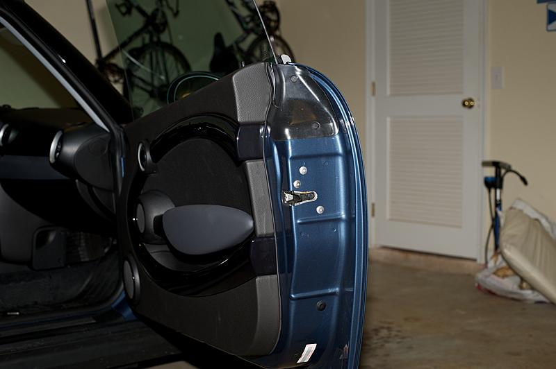

Hey All,
There seem to be a number of you with the same gripe that I have about rattles in a brand new vehicle! I picked up my R56 a couple months ago and noticed some rattling in the doors right away, which, of course, the dealer could not duplicate on my one and only attempt to have it repaired under warranty. Because my dealer is about 60 miles away in perpetual bumper-to-bumper Atlanta, I decided to use some of my own ingenuity to repair my issue.

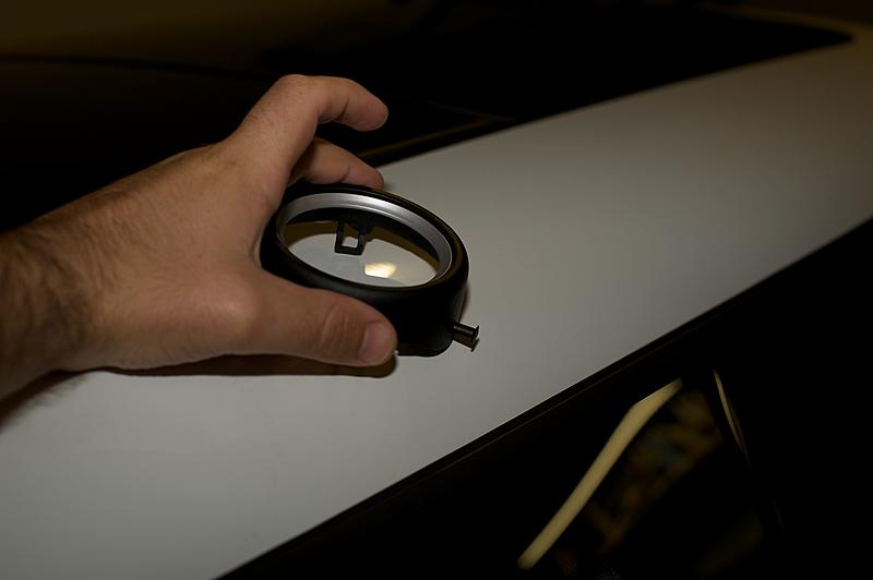

There was another thread on here that tells you specifically how to remove the outer door panels. It is really easy so here is a couple pointers: First pull down the set pin which you will find on the underside of the plastic door handle ring. This is the same round piece that supports the chrome or silver lining that goes around the door handle. Be careful not to leave tool marks! Second, you need to use a bit of brute force but pull the outer C shaped panel from the door. It is held in by almost thirty panel lock pins which can be re-used so long as you don't break any by pulling too hard.
To better insulate the door panel, here is what I found: The panel sits very close but not directly against the metal door panel. What this means, and predominantly on downshift when tach between 3000-2000 rpms, you will hear some different rattles or vibrations as the panels vibrates against the metal. I found some 12"x18" by about 1/8" foam sheets at a hobby store which will fill this gap. I secured stripes of it in an outline pattern around the door and voil-la! Problem solved. After carefully pressing the panel back in place, I used a razor blade and simple sliced off the excess material to leave a clean finish. Be careful not to press so hard with the blade that you cut the underlying paint or you will be cursing yourself in a few years time!!
Of course, if you use dynamat that will certainly give you the added benefit of damping road noise, too. However, this option costs about $10 in material for both doors and probably 25% the effort.
I attached some photos that show the before and after gaps as well plastic handle pin and what happens when you press too hard working the panel back in place...
