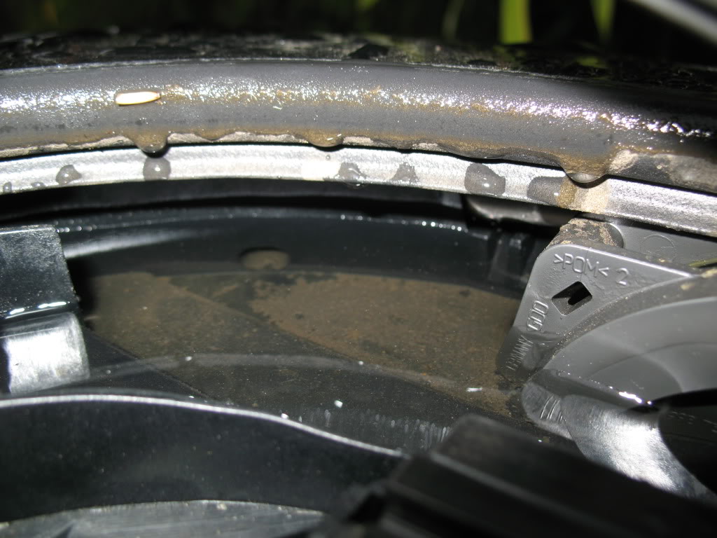

I definitely have this problem with water leaking on to the floor on the passenger side. In fact one day I drove it to work there was pretty much a pool of water down there, not just dampness I just checked on the car today after a bit of rain here and yep, its a little damp near the passenger side door seal and plastic trim. It did not even occur to me that the sunroof could be the culprit. I had the dealership replace my entire sunroof track last summer, so maybe that's whats going on? it's odd. I tried hosing down the passenger door side and could not get it to leak. I was also wondering if maybe the window was not going up all the way when the door is opened and closed.
So I opened up the sun roor and lo and behold the drain hole is COMPLETELY submerged. This is the passenger side of the car. Look closely and you will see the drain hole and on the right hand side of the picture you can get a good idea of what the water level is here.
Ouch. Looks like you got something down in the drain tube. pine needles or something getting into the hole will stuff it up...

Actually Jarid, this is just a classic case of me not paying close enough attention to what I'm doing.
So I installed some Dynamat a couple of months ago in the front wheel well area to try and tame down some of the road noise (you see where I'm going with this now) While I had the entire black well wheel liner out, I reached into that cavity behind the side repeater and added some dynamat in there. I did not notice the sunroof drain at the time and completely plugged it up!
I just finished fixing it.
oooooooooops!! Well glad to know its fixed!
