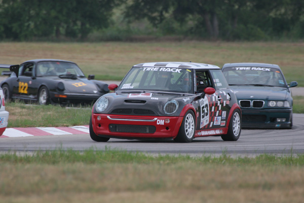

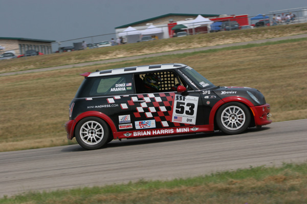

Here is a recent photo of my car, Jason Atranha in forground.
Recent mods we have been working on are: wing, difuser weight loss, gauges etc...
Regards,
Paulo #53 DM

Sorry pics did not upload
Originally Posted by meb
...no photo???
I'll try again with the pics....
Paulo

Great pics of your car and update on your car. Thanks
