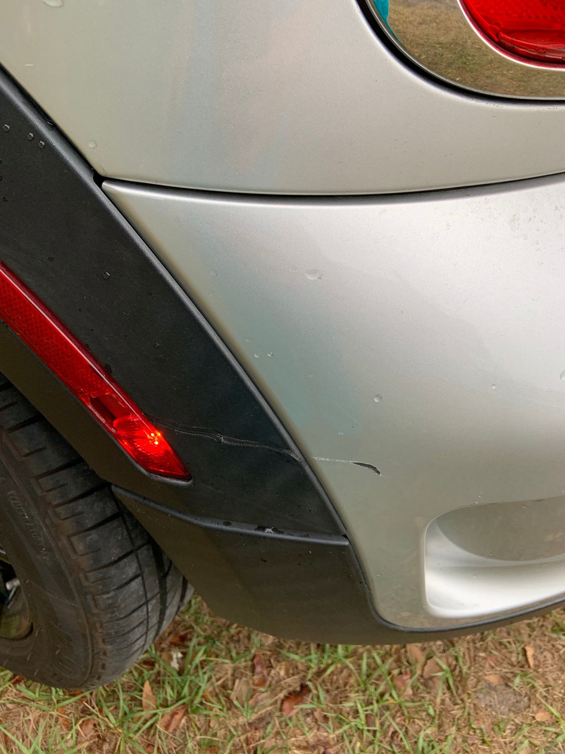

This morning I ran into my fence backing out of the driveway and was wondering how much I’m looking at to fix this? I would just leave the scratch but on my brothers car his started rusting and it looks bad. The reflecter also managed to get broke.

That scratch will not rust, its in the bumper which is not metal.

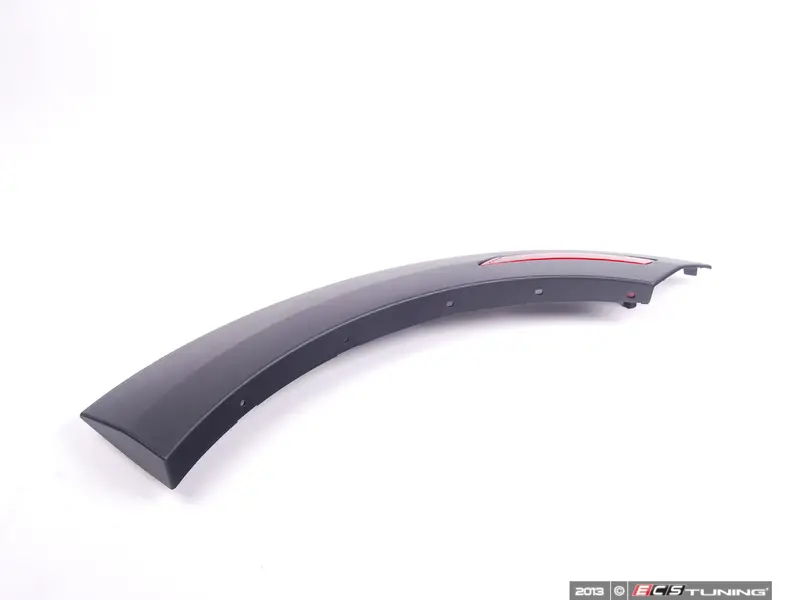

The light will need to be replaced.
https://www.ecstuning.com/b-genuine-...t/63132751333/
https://www.ecstuning.com/b-genuine-...t/63132751334/
https://www.ecstuning.com/b-helix-pa...ni07rsl-r~hlx/

Ok can I put anything on it to make it look better or is it best to leave it as it is? I have no experience with paint, body work, or anything like that.
Are those all the same light in the links? I’d like it to look oem and match the other side so I’m willing to pay a little more.

The black trim is unpainted, so not much you can do there. Maybe search on YouTube for a guide on buffing our black trim? For the bumper, you can try to apply some touch up paint to make it less visible...

I found a used fender trim with reflector for $60 is that a good price or should I just buy new?
ok thank you, I’m currently at work but will look and post what it is once I go on my lunch break.
If you are OK with the small scratch on the fender trim, a new reflector will be much less than $60

If you buy used make aure the arch trim clips on the back are ok and what they are set into, some places pull those off and damage the clips or the clip holders built into the trim. Then the trim looks like a slight Bacon (wavy) pattern when installed.

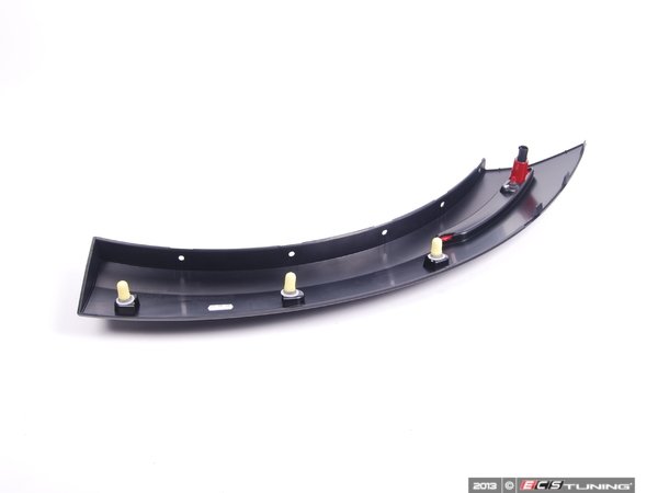

https://www.ecstuning.com/b-genuine-...-/51779801883/

Trim tool helps and making sure you start from the corner and use a towel or microfiber cloth to not hurt the paint.. Line up and snap the new one on. I would do it on a warm day in the sunshine (FL should have that) so the plastic will flex more. Unplug that light and install in reverse.
Trim tool:
https://www.ecstuning.com/b-schwaben...ieces/phr-05s/

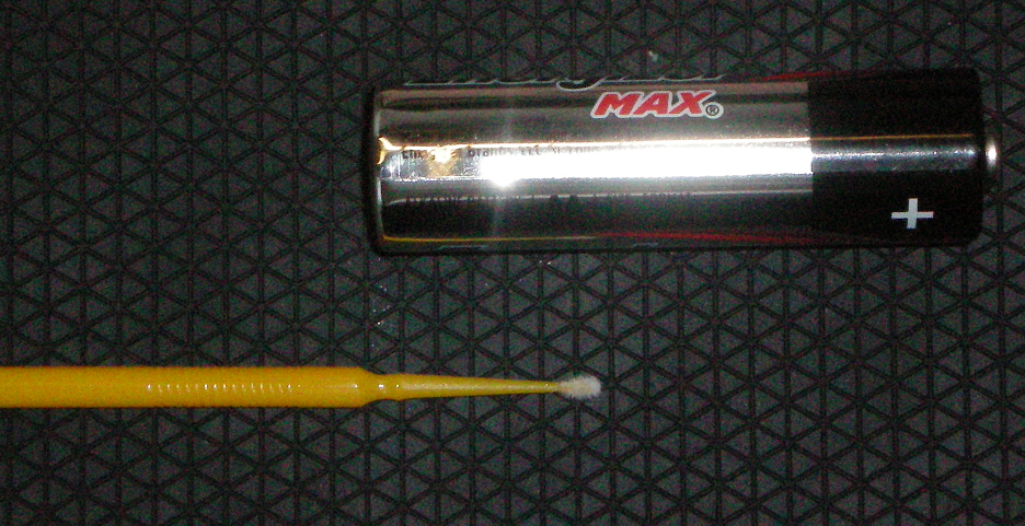

I HIGHLY recommend you get the paint from automotivetouchup.com
the stuff from the manufacturer parts suppliers is IMO always crap (ditto what's at 'autozone' etc). The color will be right but the paint is always thick as heck and makes decent application very difficult.
Get the stuff from Auto' and it is thin and much easier to work with. THEN ignore the brush in the cap, but go to an art supply store (Micheal's, Hobby Lobby) and get a VERY FINE art brush to apply the paint. You do a MUCH better job. (Have some mineral spirits for cleaning up) .... You also need to buy CLEAR to top the color . . . apply LIGHT coats and build up to the desired coverage. Apply too much paint and you get a blob.
I apply with a 'micro q-tip' when doing chips cuz you don't want to overfill the ding (AA battery for size reference)
For the arch, if you don't replace it you can make it less visible by carefully sanding to 'soften the edges' of the gouge .... don't sand the entire area!!!! Just carefully work the edges of the cut .... you can practically make it disappear ....
