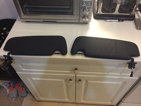

I did the whole soak with isopropyl alcohol method, worked like a charm! Taking off the visors in the F56 was super easy, no screws to worry about or anything.

Looks good. Did they come off completely or leave a slight outline around where the sticker was?

When I first pulled them off there was an outline. I just took a paper towel to it with some alcohol. Came right up. Looking at it now, you'd never have known there was anything there.

Maybe you let it soak too long? I let it sit for 10 minutes, and it practically fell off. Also, what kind of solvent did you use? I tried Goo Gone first and didn't have much success. 91% isopropyl alcohol worked like a charm.

This is pretty much right. The only thing different is that the F56 has no screws. The visor is held up by a metal clip that pops right out.
