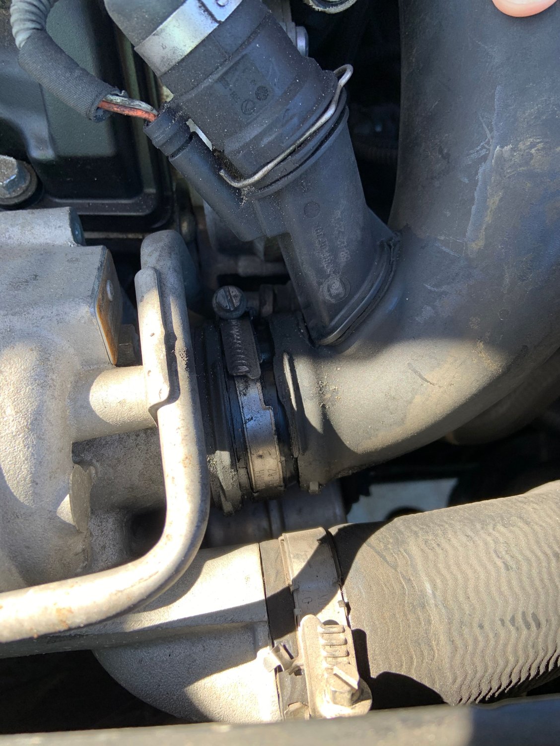

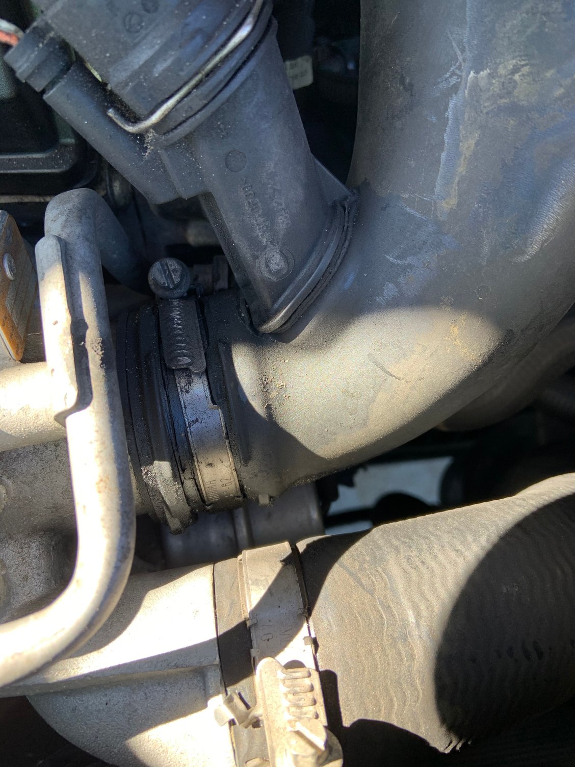

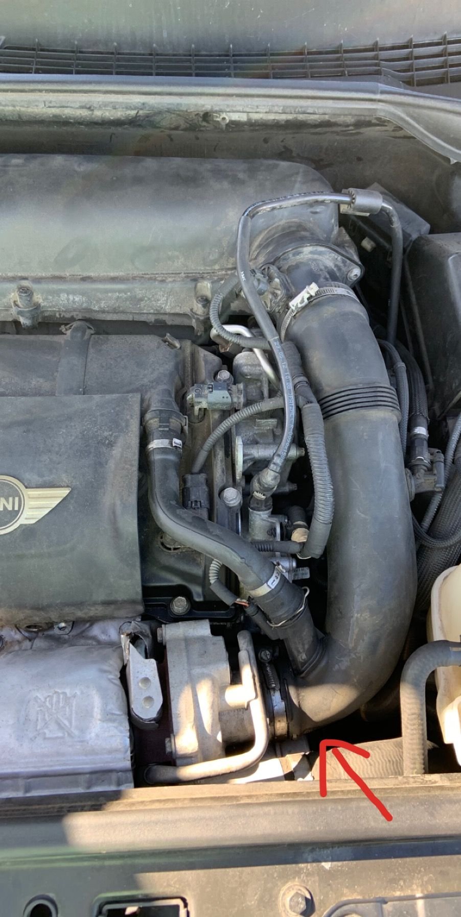

Not sure what part this is and if it’s ok to be loose.
My countryman is a 2012 S with 72,xxx miles.
I’ve been driving my countryman around for a while now and here lately it seems to be more lurchy. Because of this I decided to check the engine and noticed that this was loose and was wondering if it not being right could be the problem. Thank you all for your help.

Yes that shouldn't be loose. Leaking air is not a good thing. Sorry don't know FL mechanics but somebody should add that info soon.

The hose is cracked and needs replacement.

So is it for sure cracked or could I just get a clamp and tighten it?
is it also okay to continue driving it or should I park it until I get it replaced? Does anyone know what the part is called?

Look on Realoem.com for part numbers and names. If it was mine, I'd buy some self sealing silicone tape (amazon, homedepot) and wrap it until I could get it fixed.

It looks like the intake tube, so it is sucking, not pressure. Basically leaking in dirty air bypassing filter and some sensors... So yes, try not to drive it like this and do the temporary fix mentioned as much as possible. Source the part per MTM advise :-).

Its a pretty quick fix. Just loosen the band clamps at each end, pull up on the two metal clips that hold the hoses on each side, and pop off the wiring looms that are just push-fastened to the sides of the tube. Reinstall reverse.

I replaced the part and everything is going great. Thank you all for your help I appreciate it.
