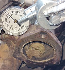

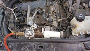

I have been fighting this issue for a few months now!
My wife's completely stock 2012 R60 Countryman has the dreaded 2C57 code (charging pressure control plausibility pressure too low) that is driving me nuts!
I have done everything I can think of so far.
The car runs fine, but it throws the code every time you drive it. Usually it's a light acceleration under a load that sets the code.
Done so far:
New coils and NGK spark plugs (recently, about a month before this issue came up)
New silicone diaphragm in the valve cover (old one was not torn, but I put a new one in anyways)
New OEM diverter valve
New OEM pressure converter
New high pressure fuel pump replaced under extended warranty
Pulled the downpipe/converter off the turbo and can visually see that the wastegate closes when putting a hand vacuum pump on the wastegate actuator. Seems to make a good seal, and there is no play or movement in the linkage from what I can tell. Decided to adjust the linkage anyway since I was already there and it's so much work to get back to that point. Set the travel distance to about 12-13mm. It was a bit more before the adjustment.
With my vacuum gauge on the actuator, I get to about 10in hg at the point the wastegate starts to hit the seat and it's super tight at 15in.
I have checked all the pipes and hose connections, even pressurized the charge pipe with about 10psi from my air compressor onto an adapter to the hose that normally comes off the turbo. I can hear the air going into the intake, but nothing else is leaking from what I can tell.
Can't wait to sell this over engineered headache!
Any other suggestions are welcome!

Man I don't want to hear that! I've been a professional technician most of my life and have never worked on anything this ridiculous to get to. It would probably be easier to just pull the motor out to replace the turbo...
I still don't see how it could be the turbo, the vacuum pump closes it perfectly fine (STUPID DESIGN BTW, why on earth would they choose a vacuum system to CLOSE a wastegate! Just one more over engineered reason to unload this car as soon as I get it fixed for her)
Thanks for your quick reply though I'll take all the help I can get at this point!

Here's a couple pics of todays work.
Attached Thumbnails 2C57 low charging pressure and/or not plausible-wastegate-closed-at-10in-hg.jpg   2C57 low charging pressure and/or not plausible-testing-for-leaks.jpg

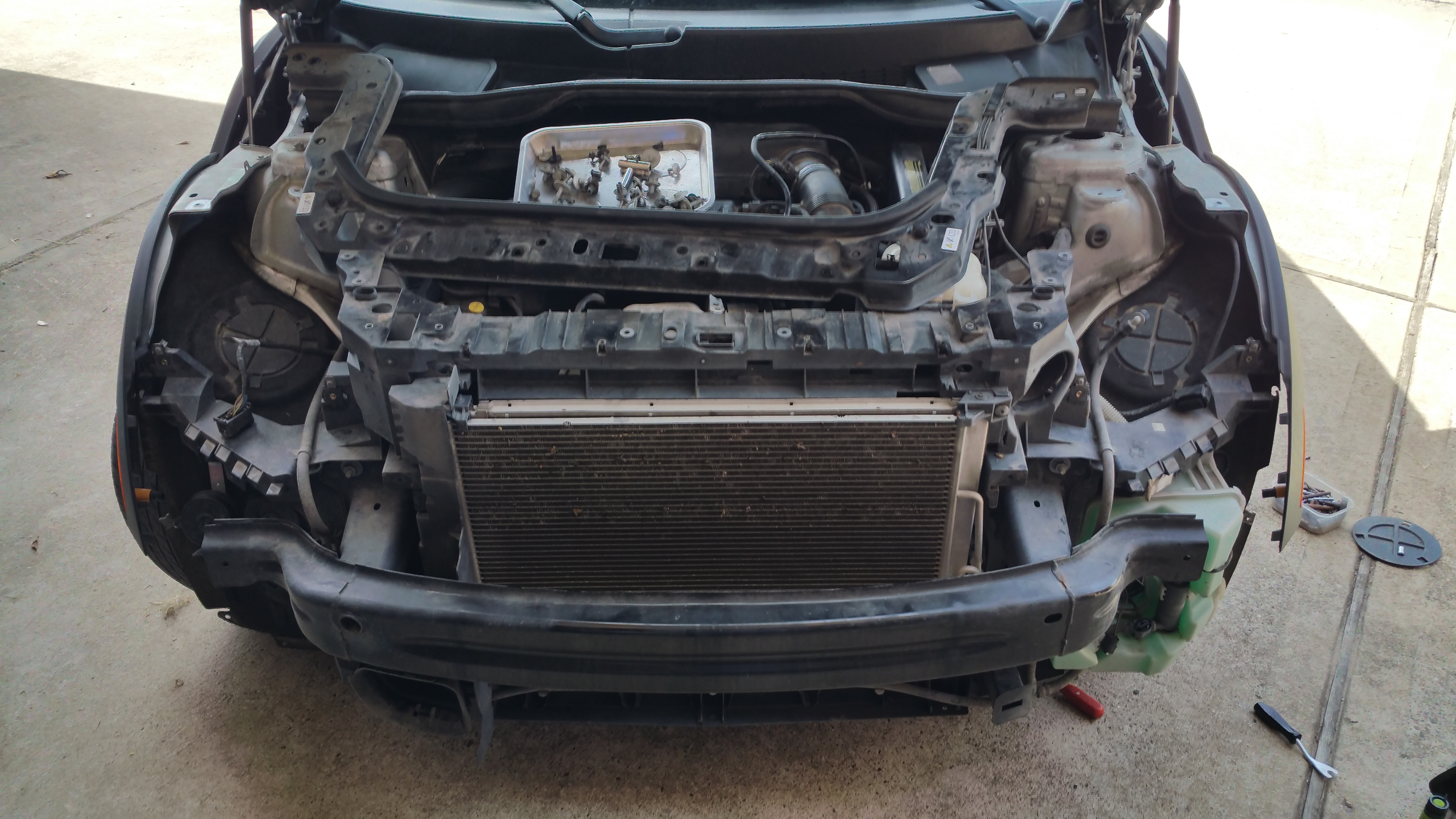

There is the service position that will move the front radiator support bracket and almost everything else out almost 3” to make more room to work. It’s worh learning how to do, once you’ve done it, it’s very easy to do.
Another thing to try sanity-wise. When I was still trying to figure mine out, it went into limp-mode so often under a load just like you. But it usually happened on the freeway or highway on inclines. I kind of learned where it was likely to do it, and started manually (automatic trans) downshifting before the hill. If you drop a gear and raise the rpms a bit, the ECU expects to see a different boost level, which will change with the engine speed and load. Try it, it just might help you stay sane until it’s taken care of.
Good luck and let us know what you find out.

You mean like this? It would be easier to drop the freakin motor out the bottom than to do that again! This is seriously about the dumbest designed car I have ever worked on!
Attached Thumbnails 2C57 low charging pressure and/or not plausible-20180629_161628.jpg

Yeah, sort of like that.... sorry.... I’ll go sit in my corner again. ;-)
Well, that’s about all I’ve got. Sounds like you know what to look for. Just a thought, did you monitor or log the boost pressure when it was driving? I ask because I thought my wastegate looked like it was closing fine, but when I watched a boost gauge (just an app on my phone and $10 dongle from Amazon) I wasn’t hitting anywhere near the normal boost level, and as soon as it would hit about 6 psi it would start to head backs down, because it couldn’t build or hold enough pressure. Where it went into limp-mode it was expecting boost and getting none. It would barely stop pulling vacuum under those circumstances. Now in the same places and situations when I apply just slight increase in throttle, it jumps right up to 13 psi and just pulls like it never did. You might have done this already, but it may be another idea for trying to diagnose it. Just a thought, anyway good luck! Keep us informed on how it’s going.
I took service mode a step further, pulled everything off the front.
I can't do an ECU tune as the Commonwealth of Massachusetts has deemed them unlawful, and I could lose far more than my license if I did it.
Before my Bluetooth adapter gave up the ghost, I was sitting at 18 psi happily, and holding it for quite a wide range.
Ordered a new adapter, will log more data soon.

Holy cow! You really did tear it down! I’ll bet it gave you all kinds of room though. I kinda wish I had done that, probably wouldn’t have taken as long with small turns at a time on the wrenches, lol. That probably made things easier.
Ok, so we are both pretty close right now to the same number. anything more and the car wasn’t happy. That’s a bummer about the tune. Mario just told me this morning in an answer about the pop and burbles that I asked, told me that it still only does it in sport, but will probably do it a bit more than now when turned on. As he put it, I’ll be able to be stealth around town and a public nuisance when I want to, lol.
But I totally see it from your side, and it’s not worth the risk. What a dumb law.
