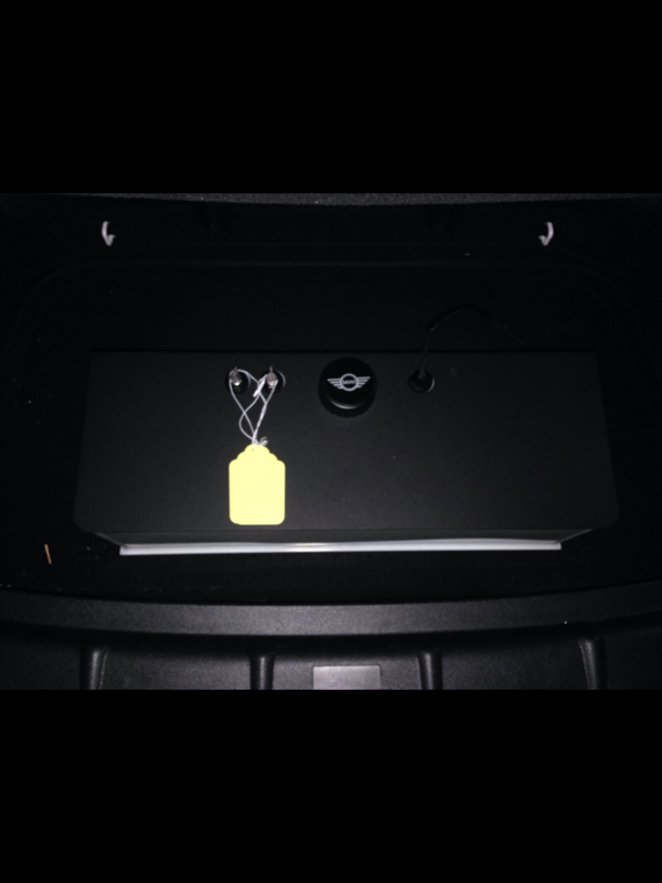

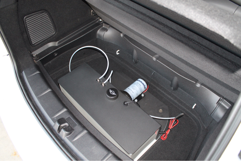

The install is not horrible if you take your time. It was a little different on the countryman as Jeff from Howerton custom fit a CTS-V tank to fit below the trunk deck to fit the countryman. The hardest part is running all the wires. ECU connections are not bad. I thought this would be the hardest part. I did it over two weekends since with the wife and kids, the only time is after they all go to bed. I have been driving around for a couple of days with the jet under the wiper blade to see when it sprays on the stock settings and I am going to be adjusting as it does not spray when I thought it would and I would like it to spray a little sooner. All in all smooth. When you order, you get a R56 specific install which walks you through each step. These instructions are a lot no better than the generic ones. Jeff from Howerton is amazing and emails back almost instantly when is had any question. With the Texas heat in the 100s, this is going to make a huge difference.
Attached is a pic of the CTS-V tank custom fit to fit below the countryman trunk deck. Best part is you can't even tell it there...

Better pic after I installed pump.

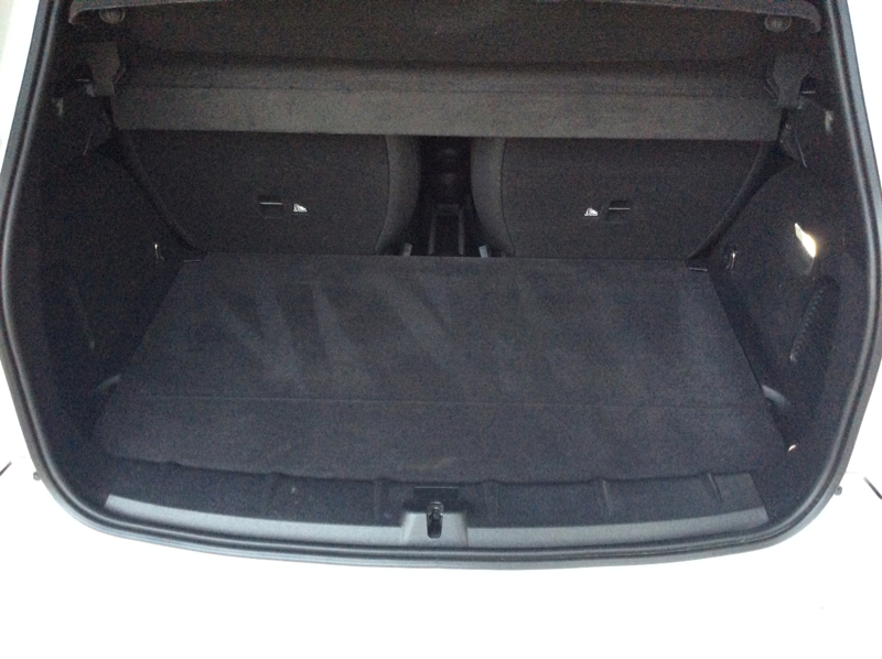

I'm about ready to finish install this week. Finally have some time. How did you get the lid to close in the trunk bed? The tank cap is too high and the lid doesn't close. Did you cut out the mat and insulation for more clearance or just don't use the lid any longer?

Yes, I have the same tank as you... What I thought anyhow. It is the CTS tank from howertown. I can't close the deck lid with the tank installed. Does your countryman have padding between the carpet and sheet metal? Mine does and it seems if I remove that padding, I may be able to get the deck lid to close.

Just figured out why mine doesn't fit. Your deck lid in the trunk sits higher than mine. They must have changed things up over the years. My lid sits about an inch lower. Check out the pics. Yours is the top pic. Mine is the next. You will see what I mean compared to yours. I will have to cut a hole in my lid.
