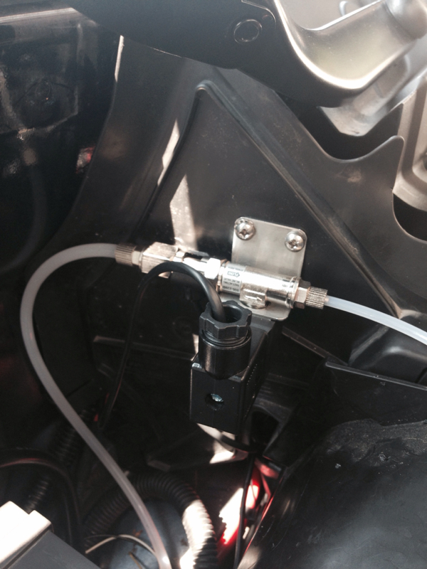

For anyone curious, here's where I have the fav mounted. It's in the battery compartment area similar to r56. Also, pic of gauge mounted. Sorry for crummy iphone pics. Will paint the gauge bezel black to match.

I installed the FAV at the removable divider in the battery area similar to the R56. I ended up rotating the c-clip up as it was causing interference with the gauge.

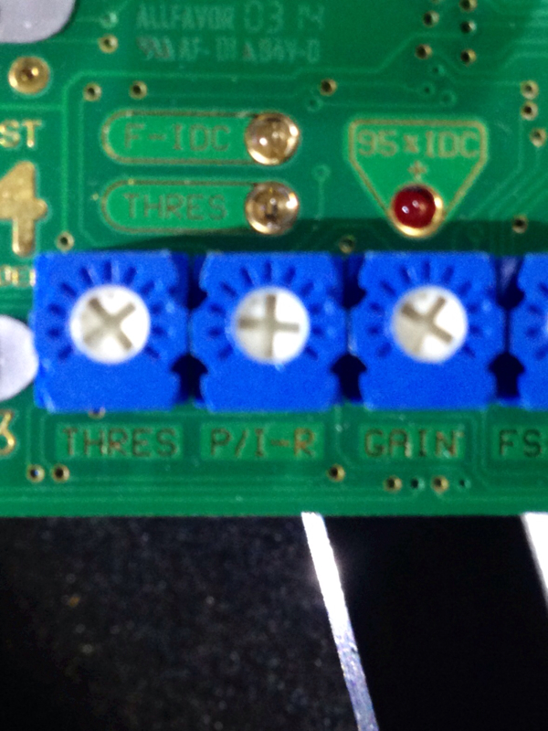

I have the control box jumper on MPS and have the system trigger at around 10psi. P/I-R 1 o'clock. My gain is set about 3o'clock due to all the heat the turbo throws out. The fail safe is also running with the WL set to 10 o'clock and WH is set to 2 o'clock. When hooking up the fail safe wire, be sure to use the brown and not the orange. Its a very common mistake. You will certainly send the car into limp mode if you use the orange.
