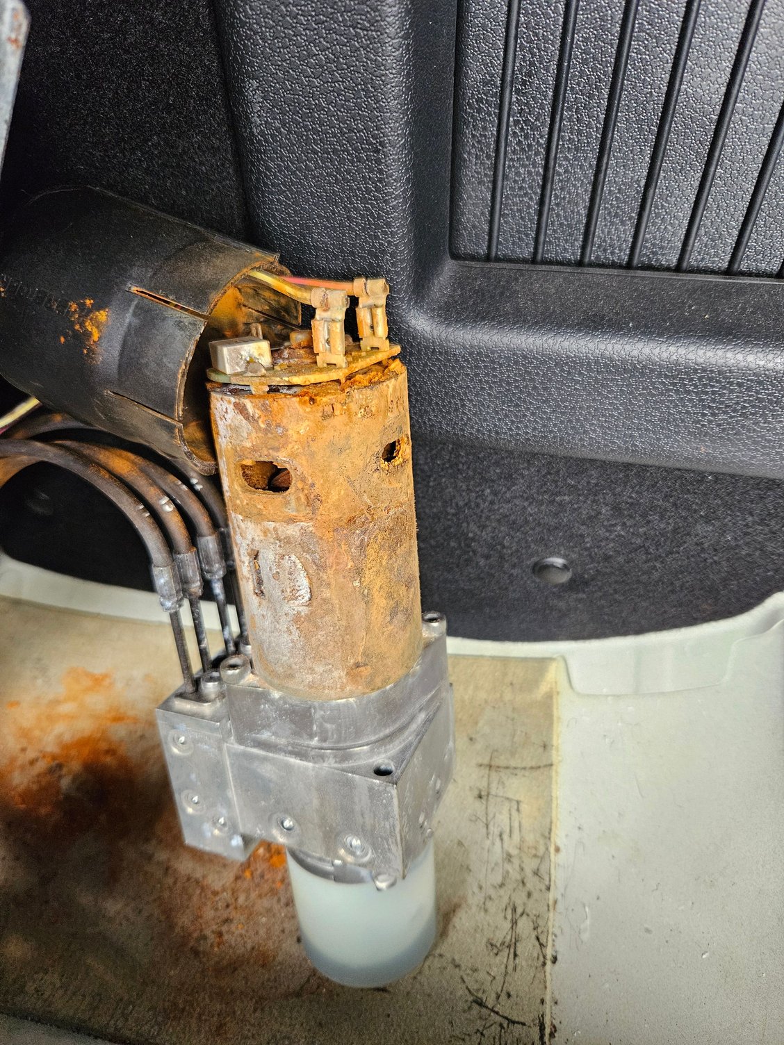

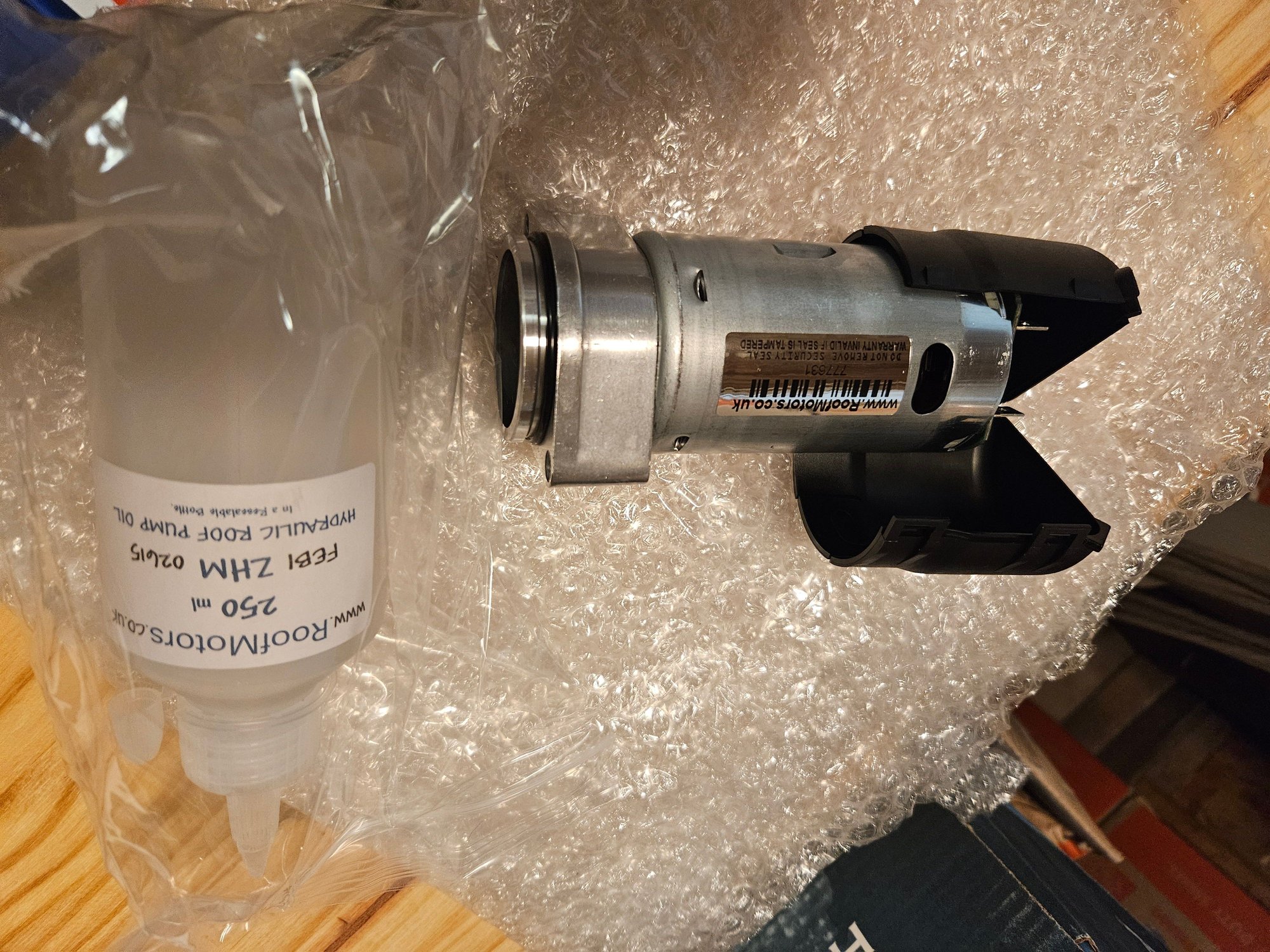

Once the foam case gets wet it's imperative that it be removed and thoroughly dried else it will act as a sponge and ruin your roof motor. Just went through this with a replacement. All in after USD to GBP, fees, shipping, tariffs, about $400 for a replacement roof motor.
Original roof motor water seized solid hunk of rust.
roofmotors.co.uk replacement, includes pcb, terminal cover, and bottle of hydraulic fluid in case you spill some.
holding the assembled unit vertical to check fluid level, best I can tell should be close to the +

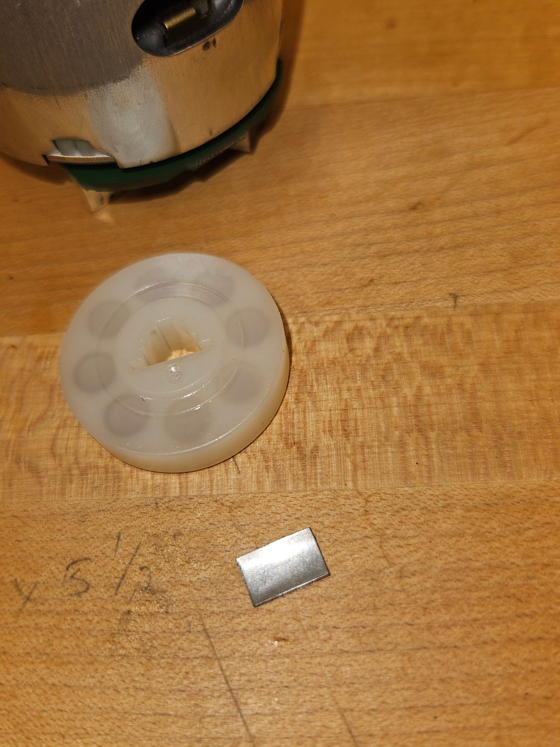

Impeller wheel. Fits to a D shaft with the piece of metal inserted from back side.
