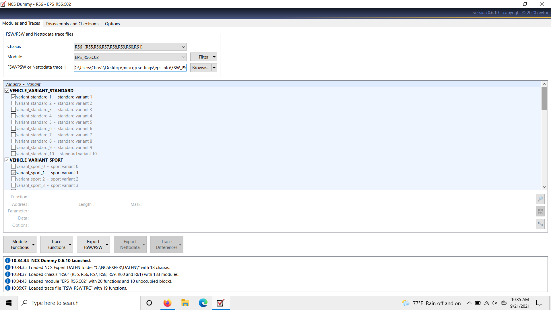

sport button stiffer steering
FYI you can set sport steering profile using NCS dummy reference pic. to get that youll need NCS expert and a kcan cable. I chose to keep the standard profile for both sport and non sport.
