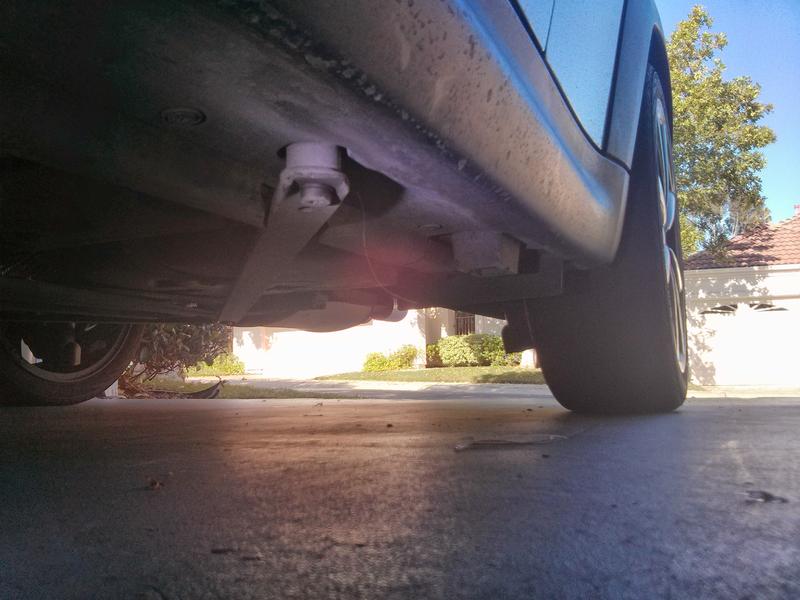

However when I looked under the roadster I noticed that there is additional bracing that bolts on to the sill about 6 inches forward of the rear jack point. See attachment.
What method are roadster owners using to get their Minis on jack stands?
Anyone try the 2x4 method placed between the brace attachment and the forward jack point?

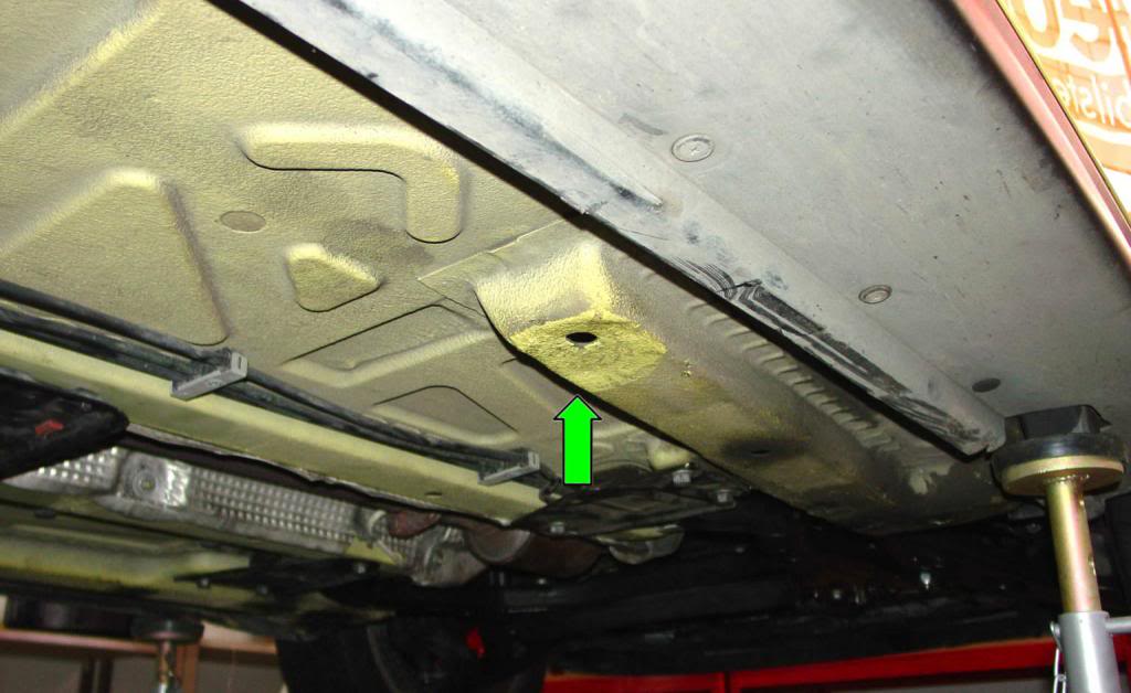

I use this point to lift the car:
(not my car, just an image I found online.)
However, I also use a wood board so the load is not overly concentrated. I also put the jack point on the far end of that area where the metal is stronger. I haven't seem it deform in any way.

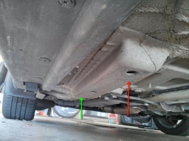

I've seen that photo. My only concern is that the photo shows deformation exactly where the jack has been placed.
Attached is a photo from under my roadster. The red arrow points at the same jackpoint and does not show any deformation.
If I understand correctly you are using a 2x4 to spread the weight along that protrusion, and position the jack nearer the green arrow.
I'll give that a go.

Actually I didn't realize the picture was the other way around (again not my car on the picture) so I am putting my jack by your red arrow. I use a nice 1/2" flat board rather than a 2x4 so its nice and flat, and the wood area is larger than the metal surface area it supports.
I also don't put the pressure where the hole is but slightly behind where it forms a bucket. The vertical wall of the metal should prevent deformation. Well it does cover the hole but the center point is not right below the hole. If that makes sense...
It seems to me that area always had a funny shape. I'm not convinced it's the jack, at list on mine. I use a low profile jack and the resting pad is quite large so I believe it is just not a precise metal forming and why the metal is not perfectly flat. I've check a few times and haven't noticed any sort of additional deformation from the time I lifted the car.
I would agree it's not perfect though, but for now it's working alright for me. Until I hear something better I'll continue to do it this way I think.
