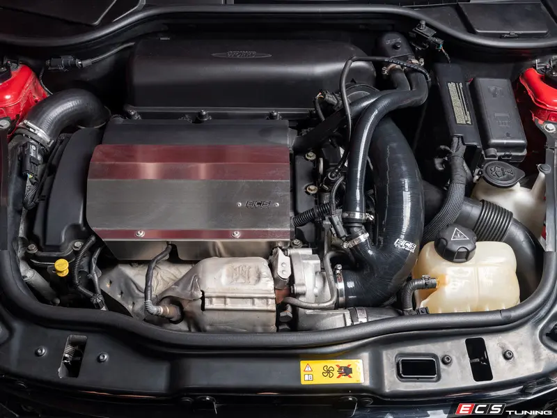

update: I picked up my car today and it runs great and I can feel the boost finally and no more half check engine light. While I was changing the k&n intake and I noticed that there is a crack on intake hose since turbo housing inlet was bigger than the stock so we kinda forced to fit that in without rubber. Once I brought it back home and it cracked right away. The thing is k&n inlet hose to turbo housing was smaller than the stock one... so I might have to install 3" straight silicone hose to fit in.

We now have an inlet hose thats stock and steps to most common larger turbo sizes.
But it cut off at the stock location half way up the side. So it could work but you would have to trim back the K&N pipe.
The factory inlets like to walk off the turbo also when they get some age.
https://www.ecstuning.com/b-ecs-part.../051716la01~c/

@MCS02 The turbo inlet was bigger than I expected so that amazon coupler didn't work at all so I bought the jmtc inlet and finally installed it with k&n intake. jmtc inlet was 1mm smaller but I figured it out though. I hear the ticking noise from the back of the engine so I don't know what that sounds from.
