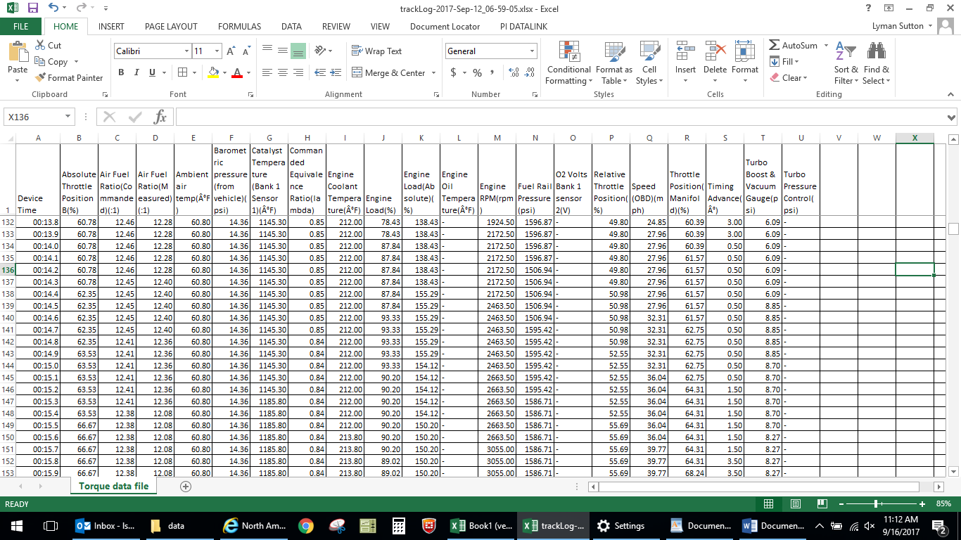

Thanks again for all of the suggestions and help. After double checking connections, cleaning sensors, etc. I finally got the Torque App hooked up and some data pulled. I really like this App!!
Attached is an Excel file with the data from a 3rd gear, 1300 to 5500 rpm run with my foot all the way to the floor the whole time. I have done this several times and the data is pretty consistent. I tried pasting the info into the thread but struck out. Below are two screenshots; one building boost and a second at the max boost that I can achieve.
After reading more on this forum and looking at my own data, I'm beginning to suspect that the high pressure fuel pump may be an issue? It looks like the A/F ratio is almost always UNDER what the commanded ratio is? That or the throttle demand from the pedal is messed up?
Any help is appreciated! HPFP replacement looks expensive, so I'd like to be fairly sure before replacing it. I'd take it to the dealership if I was confident that they wouldn't wipe my tune out.

The dealer should be able to scan the high pressure fuel pump output! Quick and simple. Even if the charge the $125 diag fee its worth it given your situation.

HPFP numbers look reasonable to me. Turbo has been checked and found to be OK, but what about the waste gate vacuum lines, tank, and pump. If the WG is opening early, that could also cause low boost. I don't know how to check the vacuum pump, but I've read that it's a common failure, and if it locks up, destroys the engine.
Can't help with your AFR questions.
