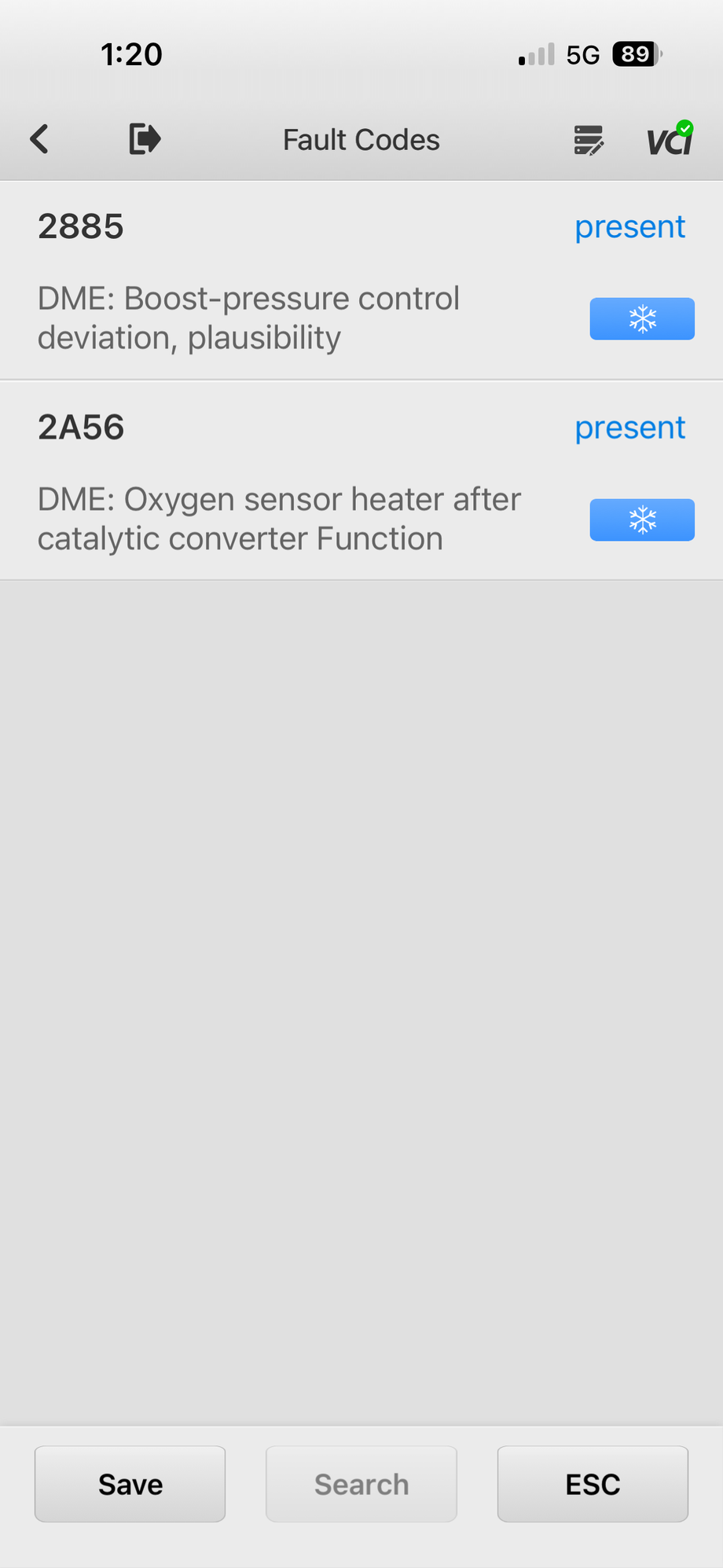

Before I went to test drive, I checked the code there was another code 2A56 popped up. Is it because I took it off before when I removed the turbo heatshield?? I erased it and didn't pop up after test drive.

Ok so you ordered a MAP sensor. Yes a bad map could cause this problem. Even if it fixes the problem you need to get your valves walnut blasted. They are looking bad. I hear people talk bad about the N14 motor, its only problem is having to keep the valves clean. It has to do with the way it vents the crank case and the motor being direct injection. The JCW N14 block is different than a regular N14. It has some extra bolstering in it. I cant remember all the differences. Usually dirty valves start with the car running bad when cold. As they get worse other problems crop up till one sticks open and the piston hits the valve. As they get dirty they don't allow air to flow well into the cylinder.
For the plug that is broken you can get a new one and splice it in.

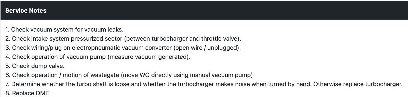

I may have missed them, but what were the results from testing/checking items 1-4?

Is the coolant level in the reservoir at the full max level when engine is cold? One possibility is that some air is trapped in the cooling system, so you may want to try bleeding it.
For code 2885, you also should check items 2-4.

I did replace the vacuum converter and zip tied both hoses attach to it. I'm getting really exhausted about this problem .. I might have to bring a mechanic to check those vacuum pump and wastegate stuffs...The coolant level is little more than minimum in cold.

I wonder if item 2 can be evaluated with a scan tool that reads pressure from the intake manifold charge air pressure sensor or the charge air duct sensor?
Item 3 is electrical tests on the converter connector wire(s) - continuity to DME and short to ground.
For item 4, the only vacuum pump that I know of is for the brake booster. Does the vacuum generated by this pump also have a turbo charger function?
(edit: The brake booster vacuum pump apparently supplies vacuum to the pressure converter valve)
For item 6, AutoZone & O'Reilly's offer free rental vacuum pumps.
Try bringing coolant level to max level when cold and also do a system bleed.

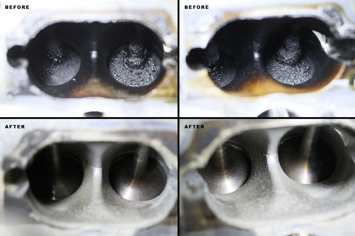

Here is a before and after picture of valves that have been blasted. I dont think this the problem but maybe a contributing factor and it will have to be done soon or latter.

If you are still getting 2885 code, you need to go back through this list and triple check EVERYTHING. Don't dismiss one component because it "might" be ok. Might be worth it at this point to invest in some kind of vacuum tool and/or vacuum-pressure gauge, too.

Wastegate movement appears to be controlled by vacuum (see item 6 in list). Is the wastegate mechanically seized or does it not get proper vacuum?

Tomorrow before I order new turbo, I am going to double check wastegate movement by using vacuum pump tester and inspection camera through o2 sensor hole.

Yup, if wastegate isn’t moving or is stuck, you’ll get the boost plausibility error
