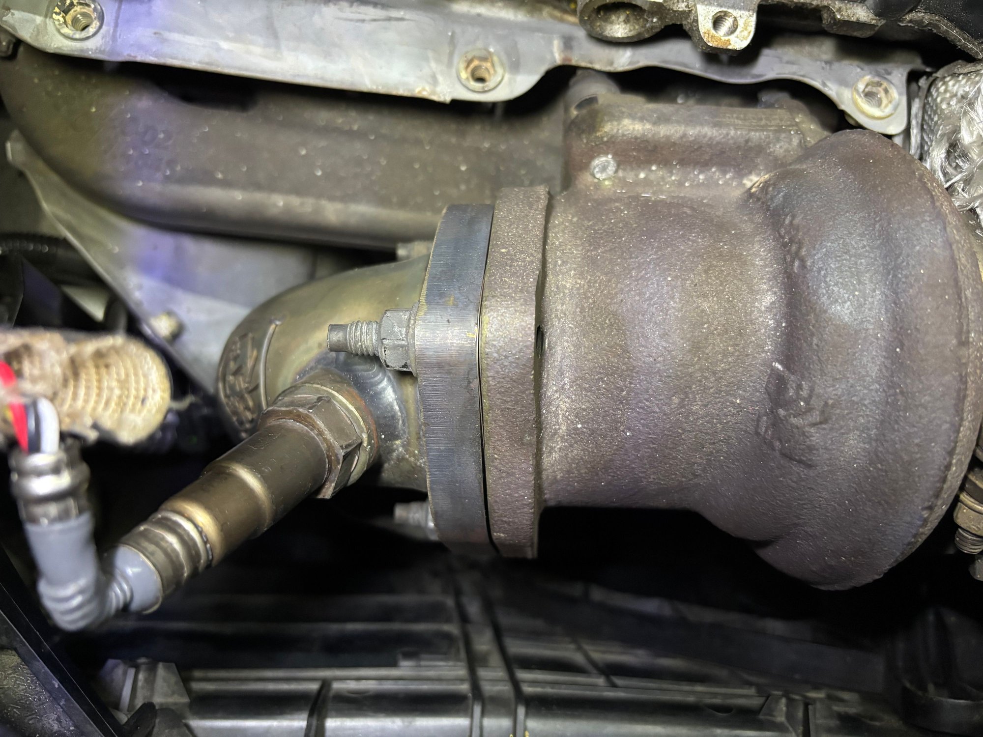

update: I found that the 3 bolts on the downpipe to the turbo were pretty loose!!! I was surprised that the bolts were not tighten as it should.. I guess the person who installed the downpipe messed it up!!
I wish I could start the car and check if it worked or not but I worked at my parent's garage and the car is pretty loud so I didn't want to get complaint from the neighbors at night so I couldn't test it yet!!! I'm pretty excited-- this could be it!

update: I fixed the exhaust leak when cold start. again, I erased the code and went for test drive and felt so much power and the boost but....driving 5 mins or so when rpm around 3500 the half check engine light and same code popped up..

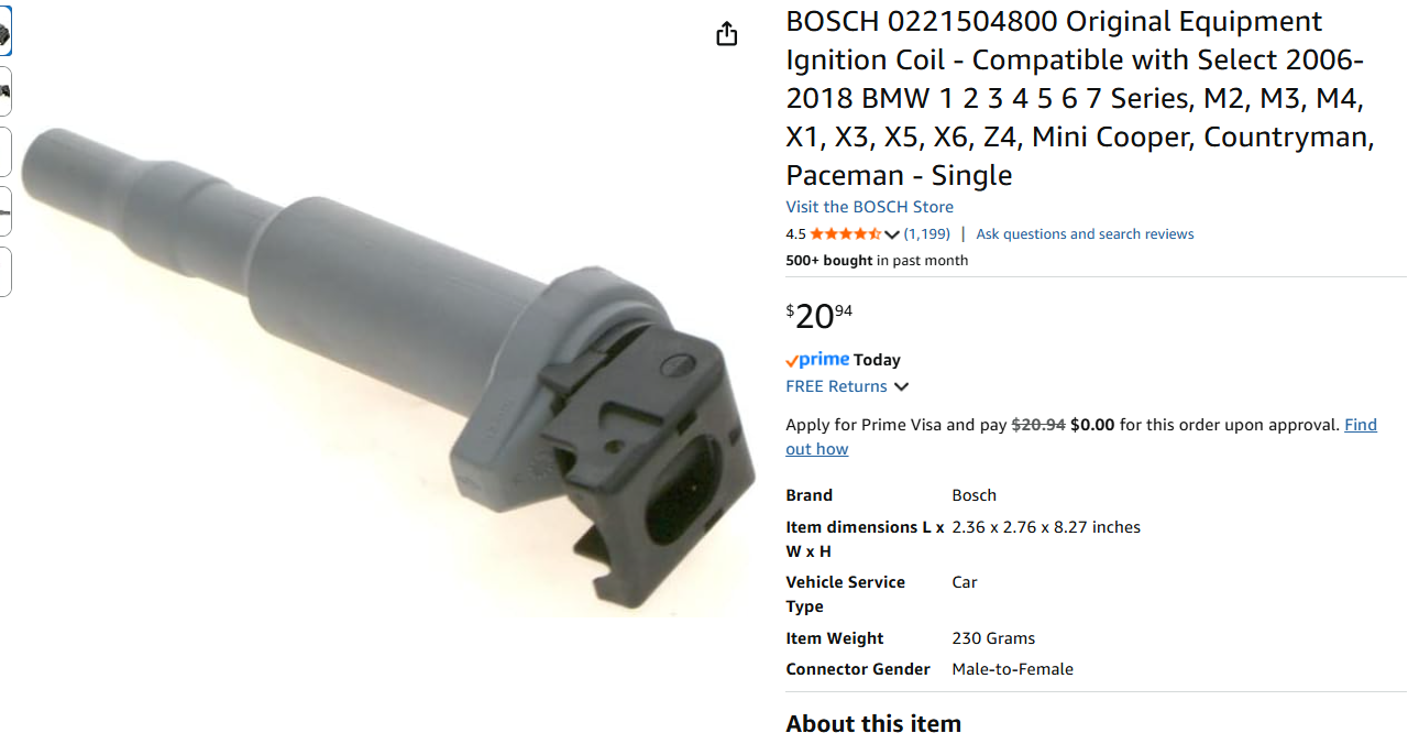

I also pulled out ignition coils & spark plugs to see if I need to replace them. let me know what you guys think as well. I think the spark plugs are not bad but coils are pretty rusty on 2nd & 3nd as you can see.

I think it’s time for a good walnut blasting. If you have a valve stick it will bend and then its time to pull the head Dirty valves can cause other problems. I had it done on my R58 recently because it had been 50k sense the last blast. Cheep insurance. The coil packs may be working but look bad. Replace them.
These are ok?
