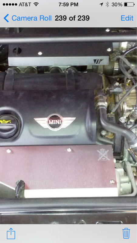

Just installed my alta turbo/mani blanket. I also wrapped the downpipe in lava wrap. I ended up removing the heat shields. Will report back after a few miles.
just curious, what did you connect the bottom of the ALTA blanket to? since I believe it's supposed to screw into the lower heat shield and I wasn't sure how it would do w/o it
I used stainless straps and connected the rings (that are supposed to get the screws that connect to the OEM heat shield) on the bottom of the blanket together.

It looks good, but isn't it having it over the oil line a bad move?
It doesn't cover the oil line. The oil line has it's own cover (similar to stock) ... let's the heat out and reflects the heat away.
