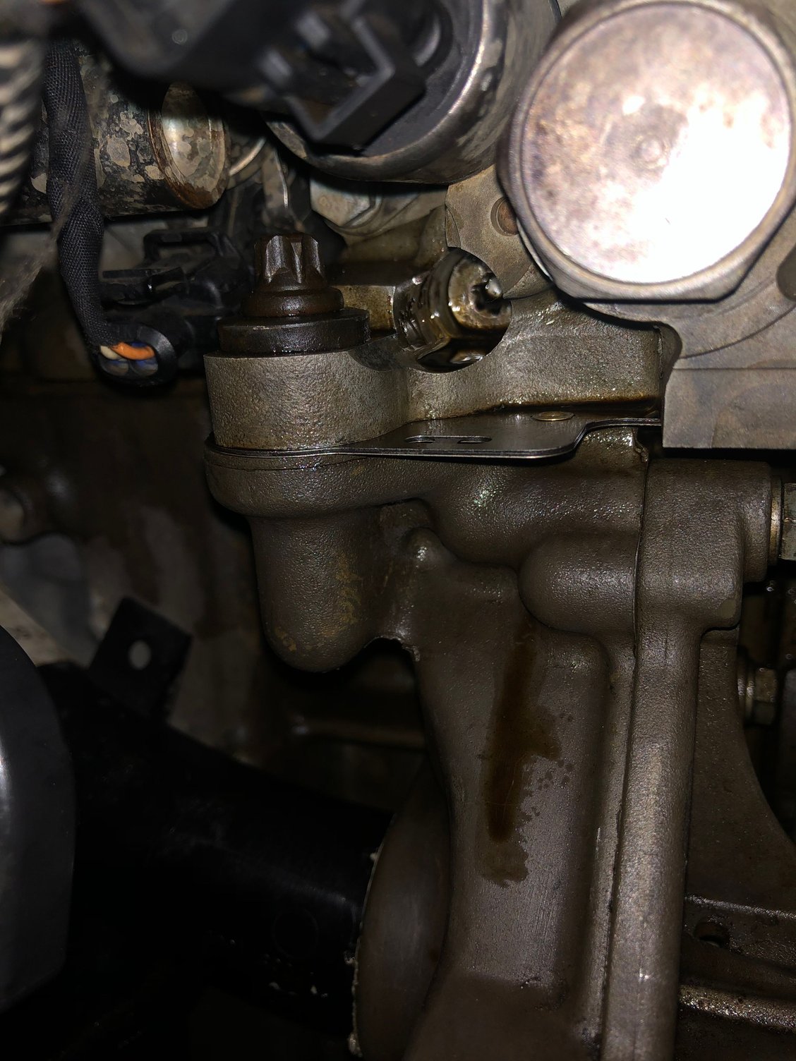

Best photo I have of the hole with the torx.
The hole is down to the back of the engine on the left side of this photo (back right side of engine)
struggling with an oil leak on my 09 r57. Seems to be coming from a torx screw/bolt on back right of engine. I was gonna try to tighten it to see what happens but wanted to post here first. I assume there is an o ring there but I have no idea what this is for. Please advise. Thank you.

Looking at that photo your oil is coming from above the torx space. Most likely a failed o'ring on the vanos solenoid which is very common. That is the large silver unit with the black connector just above the torx hole. Maybe both leaking as it looks like someone has already screwed with that torx and damaged the head.

update: I removed the vanos solenoid and the helicoil that someone previously installed came out on the bolt. I guess good news is this would explain the leak as it wasn’t tightened. Bad news is I’ve never dealt with this and really don’t want to drill a new hole. I’m hoping I can buy a new helicoil of the same size and reinstall it. Any help would be greatly appreciated.

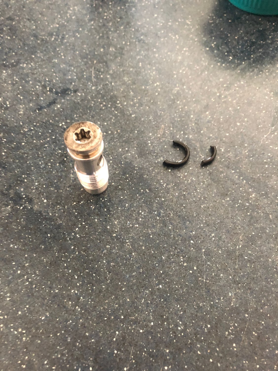

turns out it was my non return valve leaking. Remove it and the o ring basically fell apart. Very stiff and un pliable. Can anyone help with the size o ring. I hate to buy the 30 dollar valve just to get the o ring. Thanks!

Take the pcs to a hardware store. They should have one that will work.

Exactly. take it to a Ace Hardware or something of the sort ... the will have one in the metal cases of machine supplies

Here is the part: https://www.ecstuning.com/b-genuine-...367507729~oem/
The size is 9.5x2.5mm
Used to be black, now its green.
