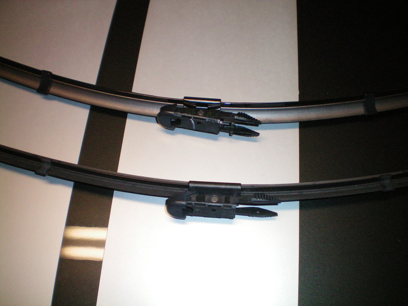

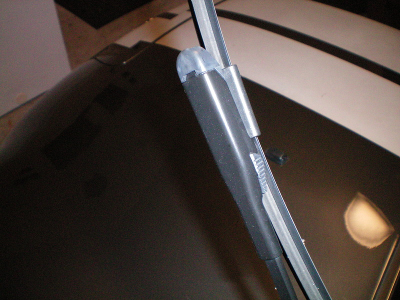

does your arm look like this one on my '15 '59?
cuz if it does it looks just like the mount on my 14 Focus
here's Ford arm on top, MINI arm below
I've not heard Ford ST folks complaining about availability .... do I think many parts dealers have bad MINI info in their database .... YES.

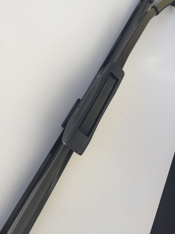

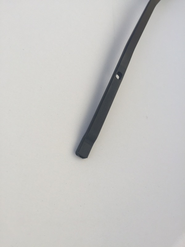

2 photos below - 1 with wiper blade on arm and 1 with wiper arm without blade:
From my 2013 R55N but I believe this should be the same wiper as the 2013 R57.
