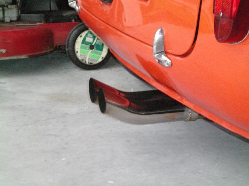

reviving a somewhat oldie
so a 15 Roadster S should get some burble in sport mode but things may need to be 'warmed up'?
it changed so many times and I never really tried to keep up.. I get my burble fix from the 79 (big twin DTM exhaust with a tweaked out 1275 and LCB) but Mrs wants to know what the sport button does on her Roadster. I tried to demo the p&b but didn't get anything, but it was a short drive.
