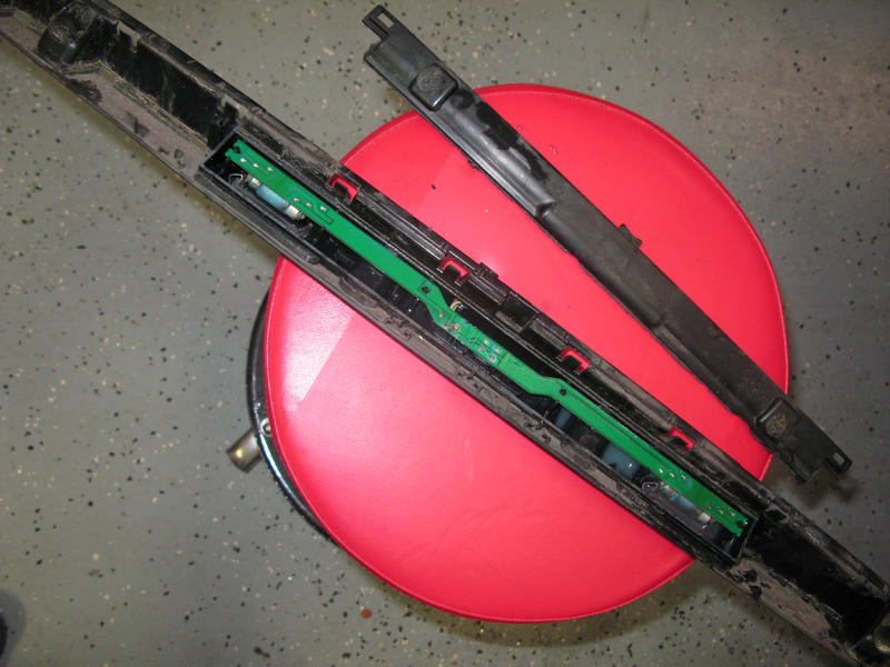

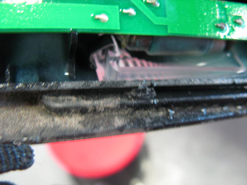

UPDATE:
I couldn't help myself; I took it apart. It was wet inside where the microswitch and the circuit board live. I have no idea how to prevent that. It wasn't as nasty and corroded as the one I replaced in January, but I'm sure it would have been in time.
Am I going to have to do this every six months or so? My MINI is housed in an air conditioned garage most of the time and rarely out in the rain unless I'm driving in it and get caught in a rainstorm. It never sits out in the rain.
I'm pretty disgusted.....
UPDATE:

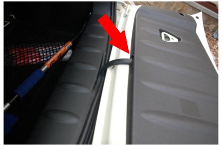

My R57 had this problem and the long term cure, after drying out the switch/handle, was to remove the rubber bung through which the wiring harness to the bootlid goes. I stole someone's R57 boot photo to make this illustration of where it is. This then drains the bootlid.
You may have to remove the whole plastic panel to get to it, I don't remember.
This does appear to make the closed bootlid drain into the boot/trunk, but that never caused me any problem and my car lived 100% outdoors.
