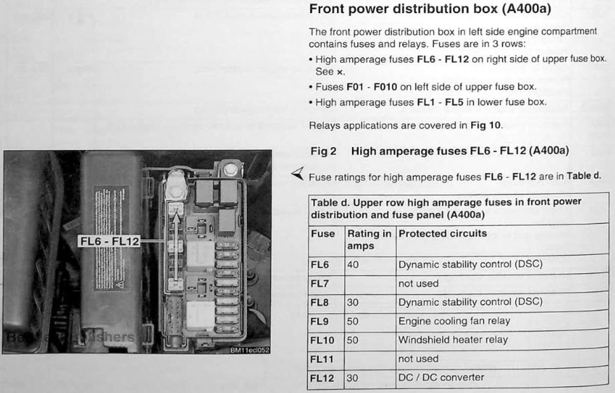

The 5DAB fault code seems to indicate a bad pump motor not a bad control module. If you have your pump motor professionally repaired, no programming or coding would be required. You would only need to use your Foxwell to calibrate the steering angle sensor and to bleed the hydraulic system.
But first use a multimeter to test whether fuse FL6 or FL8 is blown.
those 2 fuses inside look to be in tact. But sure how to test them with a meter due to them being a box.
is
is the round part the motor, correct? That can be taken apart and power run to it to see if it rotates?

Yes, that's the pump motor. Warning: Avoid trying to access the motor by removing the cover.
There's a better test. Check whether the ABS/DSC connector pin for the Red/Violet wire reads 12V with key ON. This is voltage for the pump.
Voltage for the control module is a Red/Black wire.
The grounds are generally brown wires.
