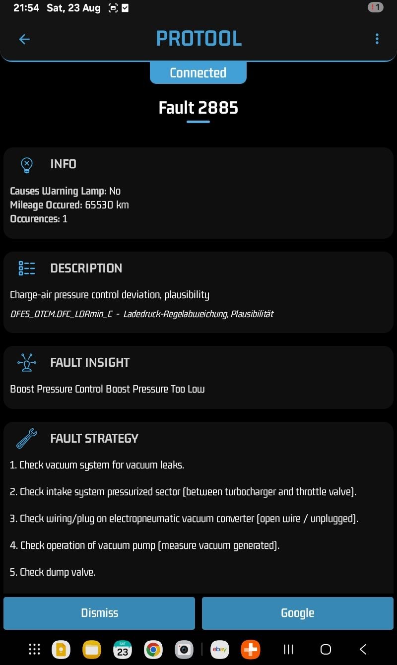

Code 2885 Testing
  1. Tested the pressure converter with ISTA, it clicked, swapped with a known good unit from a friend's car, still no change and no boost.
  2. Tested vacuum lines with vacuum pump and smoke machine, lines and vacuum tank held vacuum and also no smoke leaks thought this was good. Will come back to this later. However still currently drove awful
  3. Randomly had a code about unmetered air between pressure sensor and throttle valve, replacing said pipe with noise generator with a silicone hose. At this point the throttle response in sport mode had changed and I noticed a slight bit more punch to the acceleration, normal mode still felt sluggish.
  4. Had a random error code for the pressure sensor being implausible, replaced sensor. Has not come back up since.
  5. Tested vacuum pump with engine on and came back with 23-26 (hpa is it?) on my vacuum tester which i read on this forum is within spec. Vacuum pump okay.
  6. I had the idea that the vacuum pipes are old and cracked and when heated up could lose vacuum, so created a pipe that went from pressure converter to wastegate actuator. Acceleration improved once again.
  7. Ordered vacuum pipes from BMW, installed and once installed noticed a very big difference in the throttle response and acceleration, yet when car warmed up going past 4k brings up 2885
  8. Replaced hot side turbo to intercooler pipe. Once again noticed a few cracks from age, the car is feeling better after with the new silicone pipe, still getting 2885 when engine warmed up at 108 degrees celsius.
  9. Currently awaiting a pierburg diverter valve, intercooler and also a silicone pipe from intercooler lower cold side to the plastic pipe that houses the pressure sensor. Will report on if this changes anything.

Just in case you haven't checked code 2885 on BMW Fault Code Lookup...
In reply to those points, most covered in my post.
1) Vacuum system been replaced and checked multiple times
2) Leaks pressurised, Only two things to replace cold side lower rubber connecting to intercooler and also the intercooler, its 19 years old at the end of this year and a post on here said they eventually found a pin sized hole in the intercooler that caused 2885. So replacing intercooler as preventative maintenance.
3) Been tested in ISTA D test routine for this code error, it passed. Also used a known working one.
4) vacuum pump working and generating vacuum.
5) waiting on delivery of dump valve to test against the one that came with turbo.
6) operaiton of wastegate is a hella lot smoother than the old turbo and appears to be working perfectly
7) replaced turbo due to original turbo having a rattling wastegate.
8) DME? I hope not.
