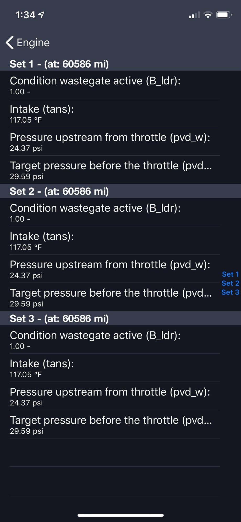

Also, I was surprised when I pulled up the code on Carly. You can see the screen grab below. A couple curious things stand out.
1. My Mini has around 76k miles on it. Those codes state they occurred at 60586 mi.
2. The target boost pressure is at 29.59 psi. That seems enormous! Is that really what an N14 JCW engine runs at?!? I guess one possibility is that that value is absolute pressure (includes atmospheric). If you drop off standard pressure of 14.7psi then it works out to just under 15psi which seems more reasonable.
