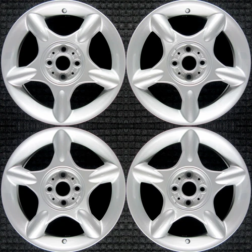

Any reason these remanufactured OEM 16s would not fit my girl's 08 Cooper S with 17s?
I assume the center cap is the same from the 17 inch rims?
Mini Cooper All Silver 16
