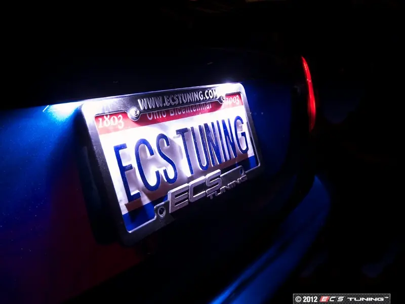

I have those in both my MINIs, remember on start up they all do the bulb check and then stop flickering after a couple blinks.
Thats my old R56 MCS in pics.

1) during the bulb check am I getting warning lights on the dash? Or is the bulb flickering?
2) in your first pic, is it just one bulb above the fog lights?

1. You will not get a bulb out error, that is caused by a non canbus bulb or the wrong bulb and no contact (ebay.. amazon... job bulbs). Those ebay/amazon bulbs will also sometimes flicker on past start up. This is caused by a bulb in LED that cannot stay on, most likely a circuit issue. With our Ziza bulbs "no bulb out error" but will get the check bulb test that is 4-5 pulses at start up then you are GTG. That pulse at start up is normal when you go from non led (halogen) to led. Once it does it, it will not do it again while driving. Just on start up the each time you start the car. Its the LKM aka Light Control Module checking the system, when you have a filament bulb (normal halogen bulb) in there it does it but you cannot see it. Hope that helps
2. Yes aka the "front position light" , these are the same bulbs on fog light cars and non fog light cars from the factory.
