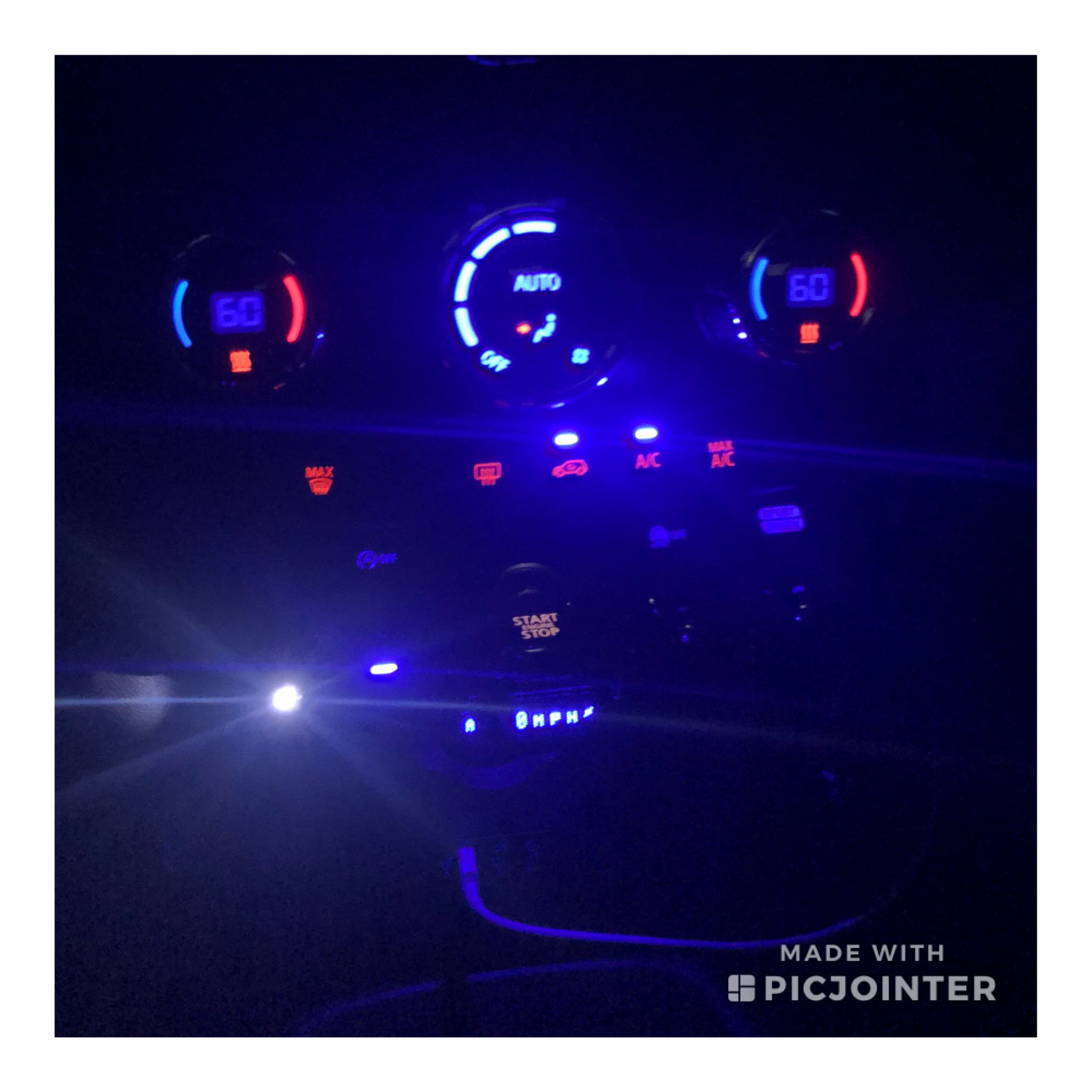

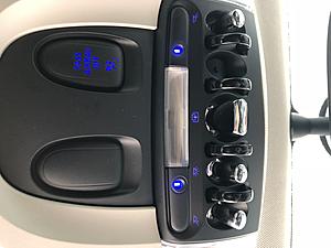

i had an adventure today with some LEDs lol. been meaning to do this for a while now. tough to get a good pic

Nice work!!!
Looks really good.

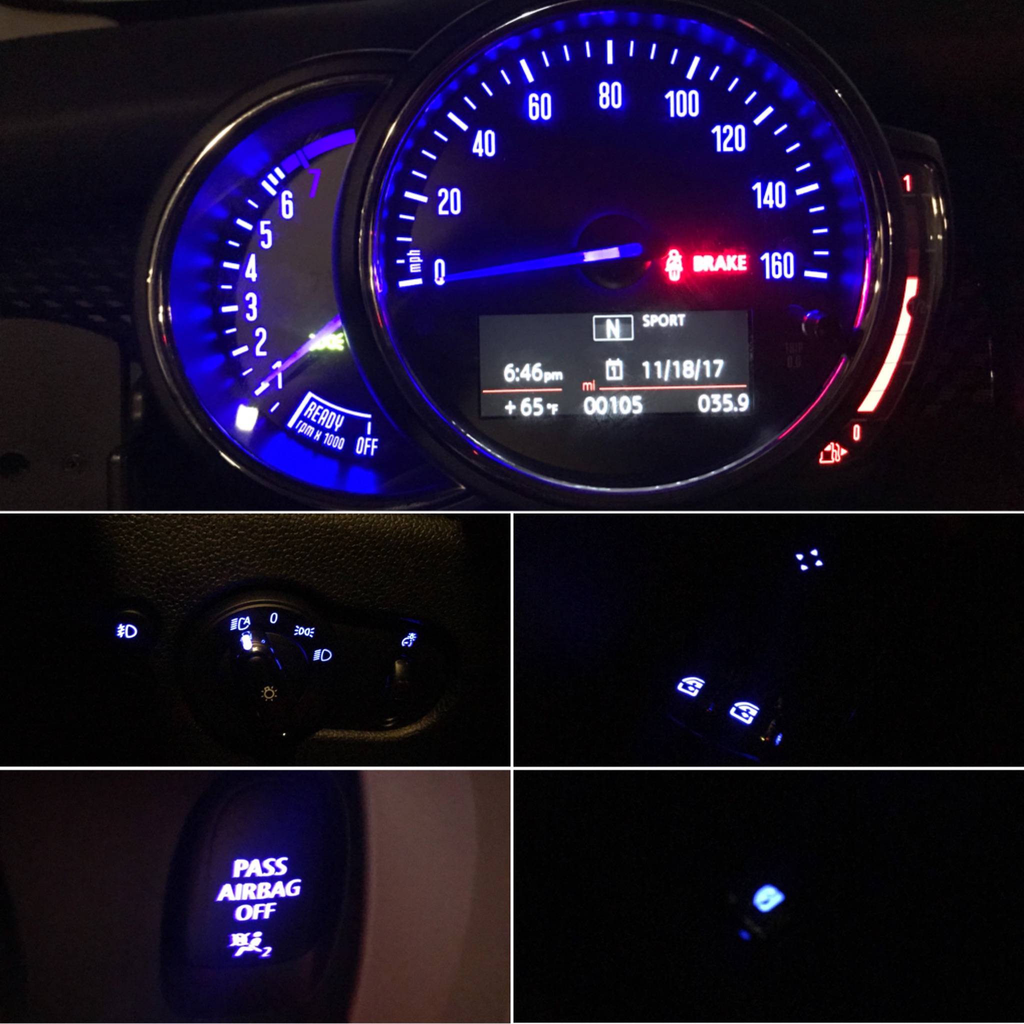

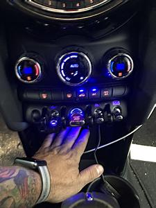

did these a while back

I just realized that I am on the wrong model thread. LOL. I saw LEDs and got excited and jumped the gun. My bad!
