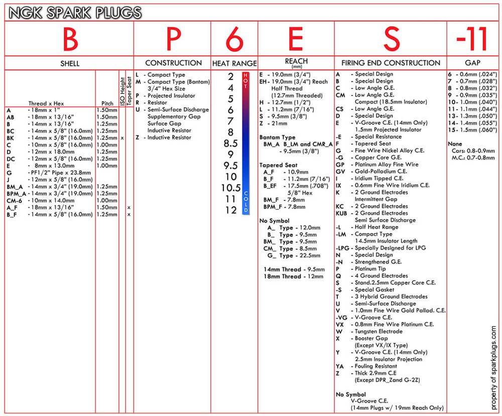

The 1422 are actually 2-steps colder than OEM S plugs. JCW are 1 step colder.

There is a ton of information on the web and even threads here on NAM with conflicting info. If you search the BMW part number for the N18 S and N18 JCW they both come up as 12122293697.
This crosses to NGK ILZKBR7B-8G. For standard plugs the first number in the NGK part number is the heat range and the second number is the gap. So stock plugs are a heat range of 7 with a gap of 0.8mm.
What is commonly referred to as NGK 1422's are NGK ILKR8E6 which means a heat range of 8 with a gap of 0.6mm.
Both have the same specs otherwise as far as thread pitch and length (1.25mm pitch and 26.5mm reach). The other difference besides heat range is the socket used to R&R them. The stock plugs use a 14mm 12 point socket while the 1422's use a 5/8" / 16mm hex socket. The 1422's are fine to around 320 hp.
Going beyond that you should use a race plug plug such as NGK R2556G-9 which are around $35-$40 each. Same thread pitch, reach and socket size at the 1422's but a heat range of 9 and a gap of 0.7mm.
