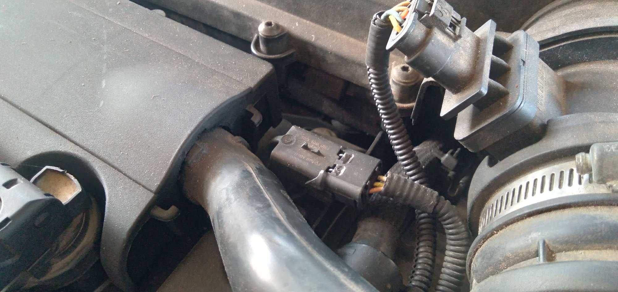

Broken connector (Mass Air Flow?)
Broken Connector general location
Broken Connector 'connected'

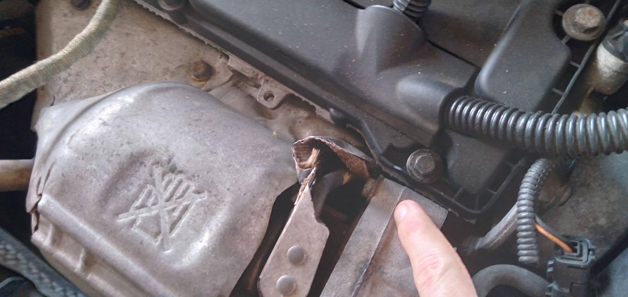

Turbo Heat Shield seems out of place >_>

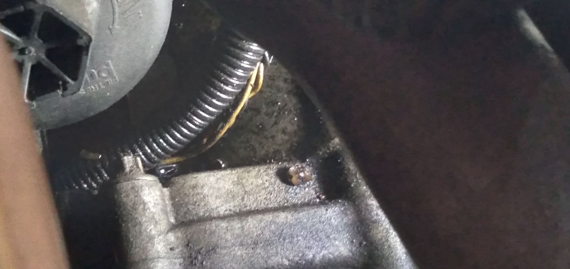

General location of suspected oil leak, oil on engine
General Location of suspected oil leak
Location of oil leak looking down through engine, oil is on the engine
Another view of oil on engine, looking down into engine
Current oil level after slow leaking for past 2 months - I know the dipsticks are notorious for being difficult to use/read ... this is how I cheat, please don't hate my for ignorance >_<

That sensor is the CAM position sensor. The plug itself could be bad, but you should look inside the sensor plug and see if the two electrical connection stems are visible and intact. You should be able to get a pig tail plug from the dealer that includes a new plug with some wires. Then you can cut off the damaged plug and connect the new pigtail. If that plug isn't making connection, then the car doesn't know the position of the cam, so it'll probably run very rough.
The pop while driving and an immediate loss of power and limp mode light, makes me think one of the hoses connections may have popped off from the intercooler. I've seen that a bunch. Follow the hose from the turbo, down to the to the intercooler and around to the intake manifold. Should be able to look from the top near the overflow tank and see if the hose connections to the intercooler are in position. If you can't see from the top, jack up the car from the lift block at the front of the driver's door and then you can see both hose connections from under the car.
That oil near the oil filter housing could be from a sloppy oil filter change. I've tried my best and it's always a certain amount of mess changing the oil filter.

P.S. - If the picture I posted in my OP isn't enough to see the CAM position sensor, let me know and I'll take more.

Based on your description and pictures, I would replace the cam position sensor and maybe the socket on the harness.
