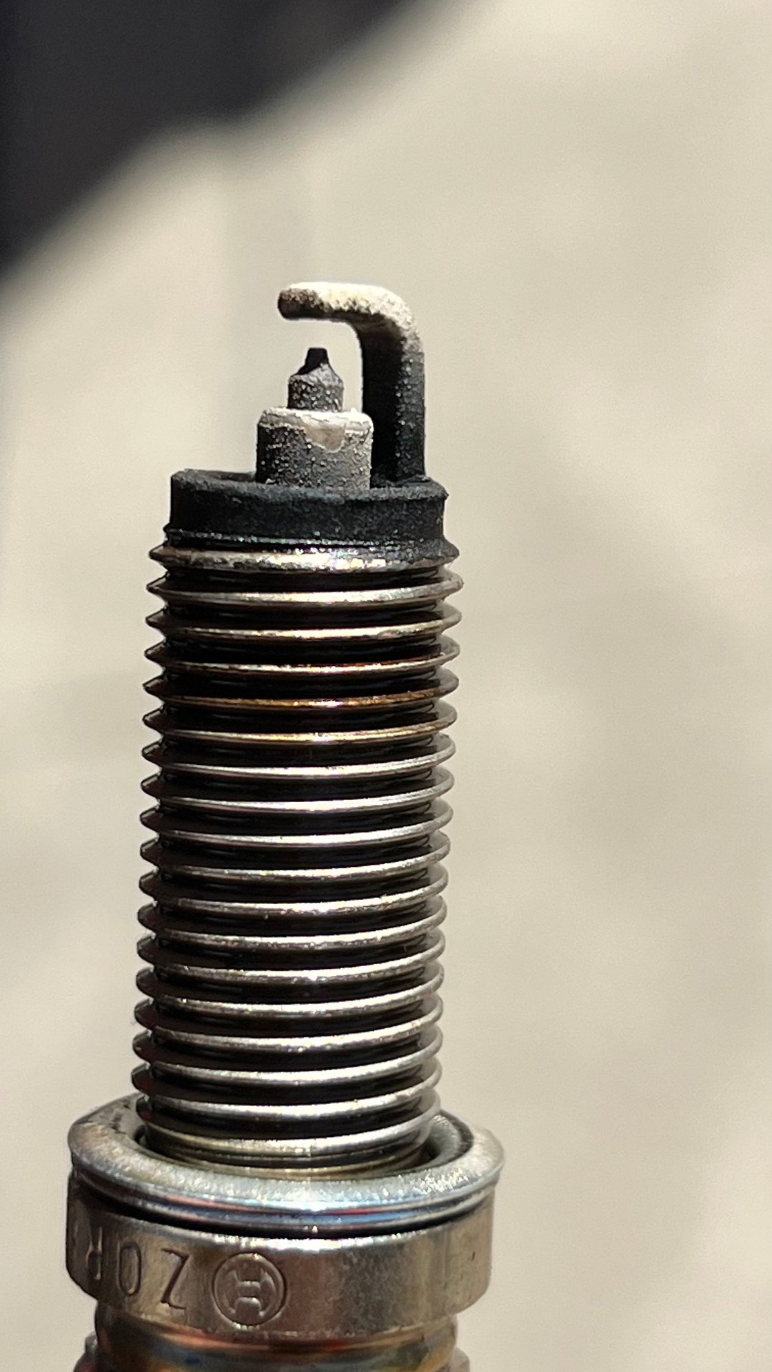

I cleaned the MAF last week to no effect.
Today I ran a compression test and all four cylinders are consistent at 225-240psi.
when I pulled the plugs I noted that the one in cylinder 1 has oil on it. Not a good sign.
I’ve seen other people mention replacing the PCV but I’m wondering if they mean just the valve next to cylinder 1 or more components. Pelican Parts doesn’t even refer to these using the term PCV.

I replaced the PCV diaphragm last week and that didn't fix the issue, but then again, the plug is already all knackered from oil. Gonna throw a fresh plug in and see what happens. If it gets oily again I may have to bite the bullet and take her in to a shop, at least for diagnosis.
Any idea if my compression readings being so high is indicative of a problem?
