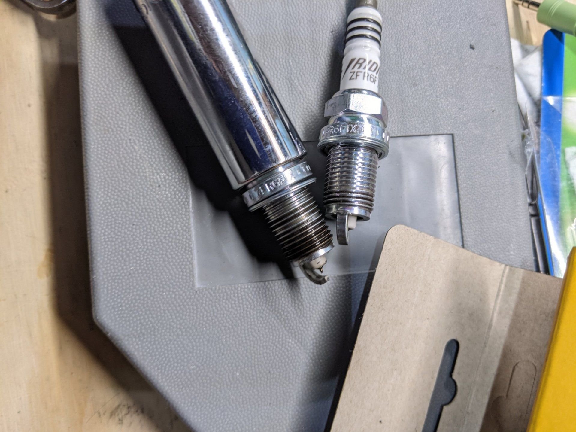

The other day, pulling up to a stoplight in my '03 MCS, I noticed shaking, a wheezy/rattling engine note, and the dreaded flashing CEL (which went solid after a minute, presumably once the computer turned off fuel to the bad cylinder). After limping the rest of the way home, my code reader confirmed a misfire on #2.
I was hoping it was ignition-related—I still had the original coil pack and spark plug wires ~155,000 miles in—but replacing those parts and the plugs didn't buy me anything. I cleared codes and let the engine run for 30 seconds or so to make sure it didn't get better. Pulling the spark plugs again, I noticed that the new #2 plug was more significantly more oily than its neighbor. Too, there was a little wisp of smoke coming out of the #2 plug well.
What am I looking at? Bad/clogged injector (although it's been smelling like it's running rich)? Or something more serious like piston damage? (The engine did run a quart low on oil once or twice in the past, before I fixed the crank seal.)

With all the oil on the threads of the plug it makes me think you have a valve cover gasket leak. Oil leaking into the spark plug well can cause misfires. Did you notice this? If so, clean the plug and the rubber boot on the wire, button it back together and fire it up.

do a compression check on all cylinders then a leakdown test on #2 assuming it is not sealing correctly. Oil on the plug threads can be a leaky valve cover gasket, but on the tip... that does not look good.

I don't think it's a leaky valve cover gasket—the spark plug itself is clean.

Well, it looks like it's pretty dead. I didn't want to run the engine to warm it up properly for a compression test, but the cold numbers are:
125 psi
30 psi
130 psi
130 psi
Which pretty much screams blown rings, I suspect? If it were a valve stuck open, I'd expect no compression at all on that cylinder, and I don't/didn't get the puff of blue smoke in the morning I'd expect from bad valve seals. e: for some extra confirmation, I put a capful of into the cylinder through the spark plug well, and got 40psi.

I would suspect a burnt valve with those numbers....

with 30lbs compression, and you add oil, if it was rings, test pressure should have went higher.....you have a large leak somewhere....burnt valve, head gasket, maybe burnt piston could be possible also
Time for a leakdown test with #2 piston at exact TDC.....either that, or just pull the cylinder head and have a good look around....it's gonna have to come off anyway
