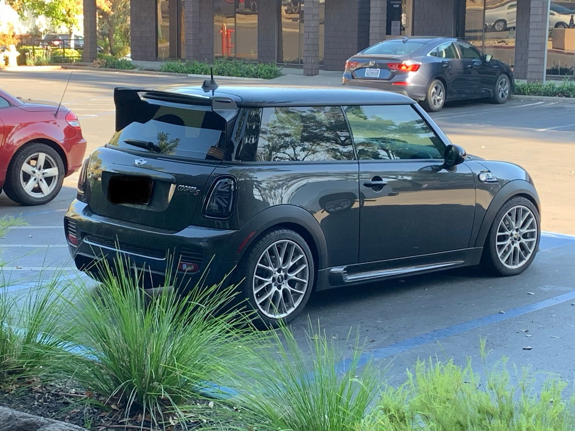

You are an awesome dad. If the turbo fails, go all out and get Stage 3 RPM tune from MarioKart on this forum. Need turbo, intercooler , Downpipe, etc and you'll love it so much that you will keep the MCS for yourself and give the kid some Toyota Yaris!
my kid certainly wants to keep mine.

Lol thanks! that’s one beautiful mini. I just want to get this thing running good so I can get back to my boat lol.
