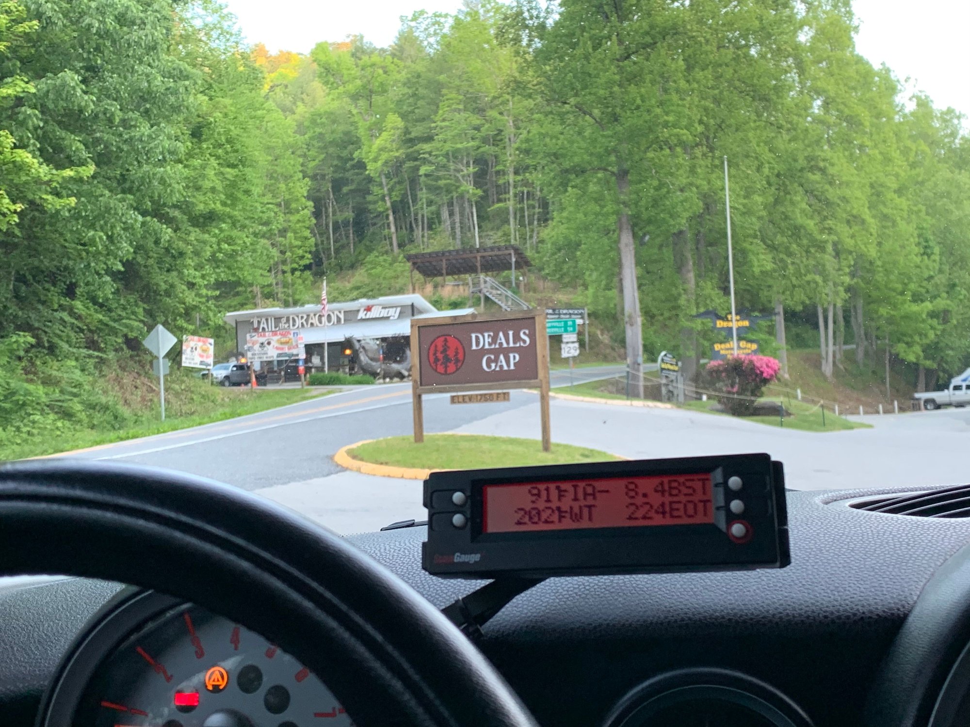

Warning lights, haha. Much easier to watch things than to let a computer tell you something is wrong or not. I got nothing when I’m coolant reservoir split, just coolant loss and I didn’t have the scanguage at the time, this made me get one.
I think there are 2 of them for sale in classifieds as well for under 100 bucks, worth every penny.
