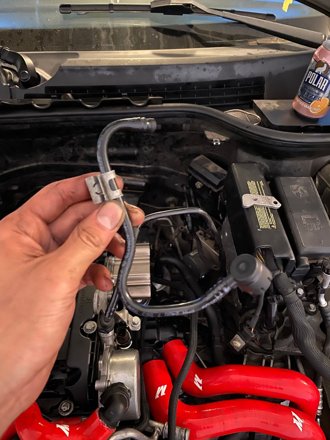

Hello,
I'm currently rebuilding a 2010 MIni Cooper S (R56). I am completely new to automotive, and really need help identifying where these parts go...
Attached are a few images. Any and all help would be MUCH appreciated!
Thank you!

First piece looks like the top part
of the heat resistance plate for
the turbo oil line:
https://www.ecstuning.com/b-genuine-...e/11657634747/

Second part looks a little like part of the vacuum line to brake booster, but hard to tell from the one view.
https://www.ecstuning.com/b-genuine-mini-parts/vacuum-pipe/34332753124
Some other vacuum connector is my second guess.

Second picture looks like a transmission vent pipe to me.
https://www.outmotoring.com/vent-pipe-24007563920.html

Bingo.
My 2nd gen doesn’t have one (manual transmission).

Your pictures are being shown fuzzy. Can't make out what 2nd pic is showing.
Suggest repost pics. However, the first pic:
This bracket secures the small turbo cooling line coming out of the thermostat manifold.
The bracket is mounted piggyback to the vacuum pump lower mounting bolt. Then, attach the coolant line to the bracket using a 6x12mm bolt.
see RealOEM.com (BMW/Mini parts diagrams)

Not sure about the first pic, but the part in the second pic is definitely the transmission vent breather tube for the Aisin automatic transmission. If you need a picture if where it goes, I can provide one later today.

The first part could be the holding bracket of the water line that goes to the turbo and the expansion tank. It may attach to the lower front bolt of the vacuum pump.
https://www.realoem.com/bmw/enUS/sho...diagId=11_3946
Part 11

https://www.ecstuning.com/b-genuine-...e/24007563920/
and
https://www.ecstuning.com/b-genuine-...e/11537568433/
Is what it is.
