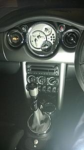

Coolerworx in my R53, available for the 56 too, just needs the spring they supply disconnecting really. Most don't but most aren't mechanics thinking about the simple fact the Mini already has the spring inside the gearbox and this if connected makes the gate twice as stiff to get across, especially reverse. Not a cheap thing even if a rip off of the CAE but it does work, the frame is 1mm thinner, and some bits need looking at like adding threadlock to stop things loosening. OK overall.
