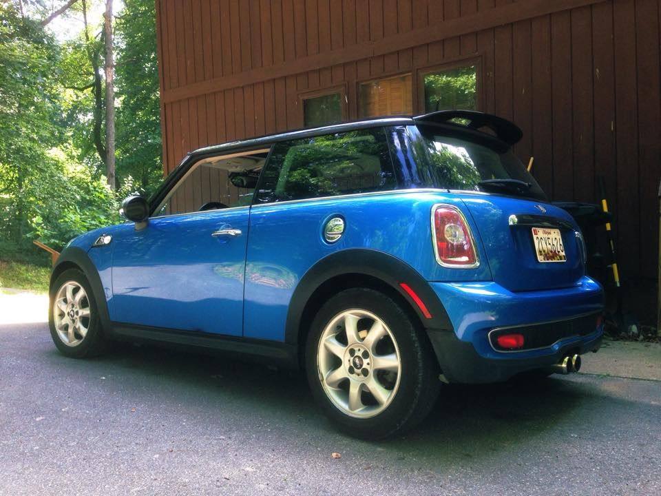

2007 cooper s - transmission failure at 170k. First it started slamming hard into 4th gear, then eventually all gears above 3 started slipping. Replaced with a 65k mile unit which got a full fluid and filter change before installation. 65k fluid looked good, so I would say 80k changes would be optimal and safe.

Engine looks original, but it has had a lot of maintenance done to it by the previous owner. Turbo, water pump, timing chain, hpfp, valve cover etc. I only paid $2500 for the car, and the transmission cost me $300 + $100 for fluid, gasket and filter + a weekend's work to swap it out. Car is at 174k now, been using it all winter as my daily, and it gives me no problems, doesn't even have the oil consumption issues that my friend's lower mileage and newer clubman has. If the engine takes a dump I'll either part it or throw a used one in and keep beating on it.

Yeah, probably optimistic, but the car had given no indication that it was on it's last legs, and between selling it to a junkyard vs spending $300 for a trans + $100 for fluid and filter + a weekend's work, it was a no-brainer. It's at 174k now, and I've been using it as my winter daily. Previous owner had taken the hit on all the major problem areas, and the car runs strong. Averaging 34mpg, no oil consumption issues, no leaks, I was even going to do a carbon clean on it while it was torn apart for the transmission and was surprised how clean the valves were, so I didn't bother. I still have less than $3k into the car - including purchase - and it's worth it until it has a major failure just to keep the mileage down on my other cars.
