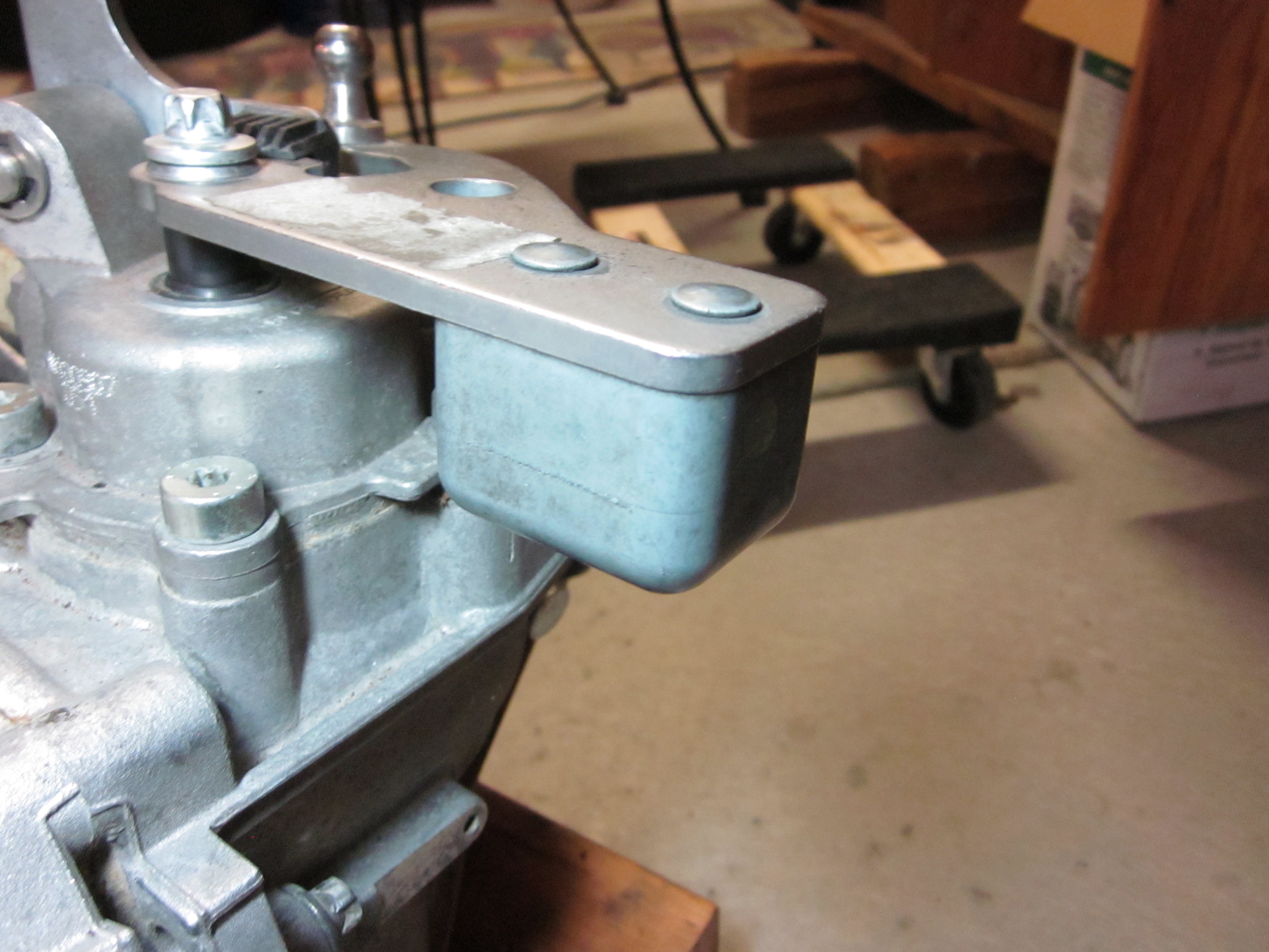

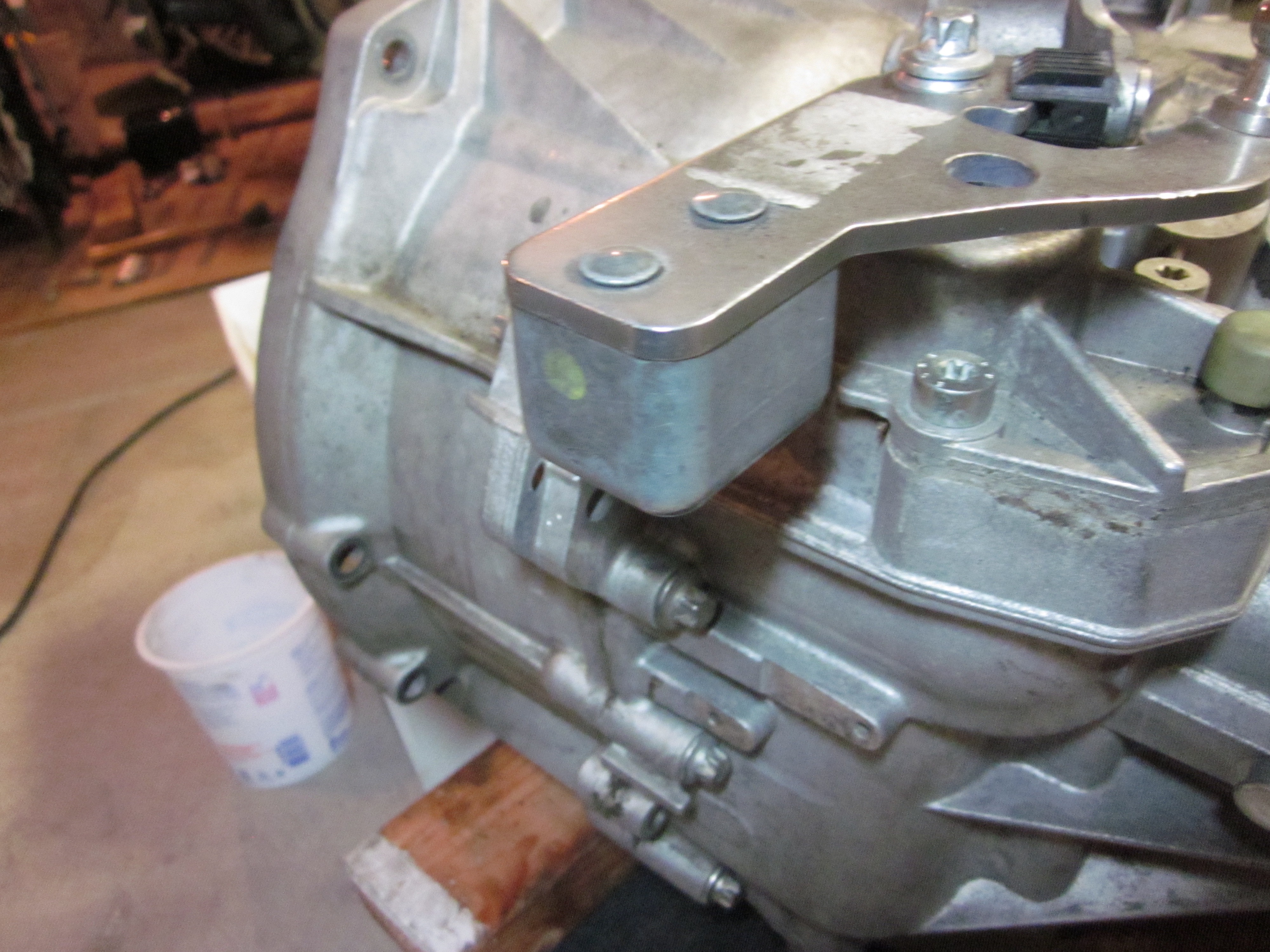

Here's a couple pics of the "transmission shift lever counterweight" --- for lack of better terminology, from my '07MCS. Note it's all metal, not black, and altho not shown, it's solid on the "bottom".
Looking at my "jack inserts", they're all black, not metal, and have a "recessed" bottom. Both are approx the same size, but I can't determine how the jack inserts are mounted --- I'm too damn lazy to crawl under the car to take a pic.
As russellg suggests, take a look under your car for the jack inserts --- it's easier than removing stuff to check for the "--- counterweight".

[QUOTE=oldbrokenwind;4336483]Here's a couple pics of the "transmission shift lever counterweight" --- for lack of better terminology, from my '07MCS. Note it's all metal, not black, and altho not shown, it's solid on the "bottom".
Thanks everyone for their input, I think Scudder44, Squawskibum and oldbrokenwind might be right, the picture of the transmission shift lever counterweight looks a lot like the part. It's solid metal and quite heavy, I'm not sure why the colour was so black but when I ran it under water it lightened to a dark grey. Strangely the shift lever doesn't feel any different at all... Do you think the part is vital and that I should get it re-inserted?

Yea, it's a balance weight. You can see above that the newer part is one piece as I bet they had some issues with some separating.
