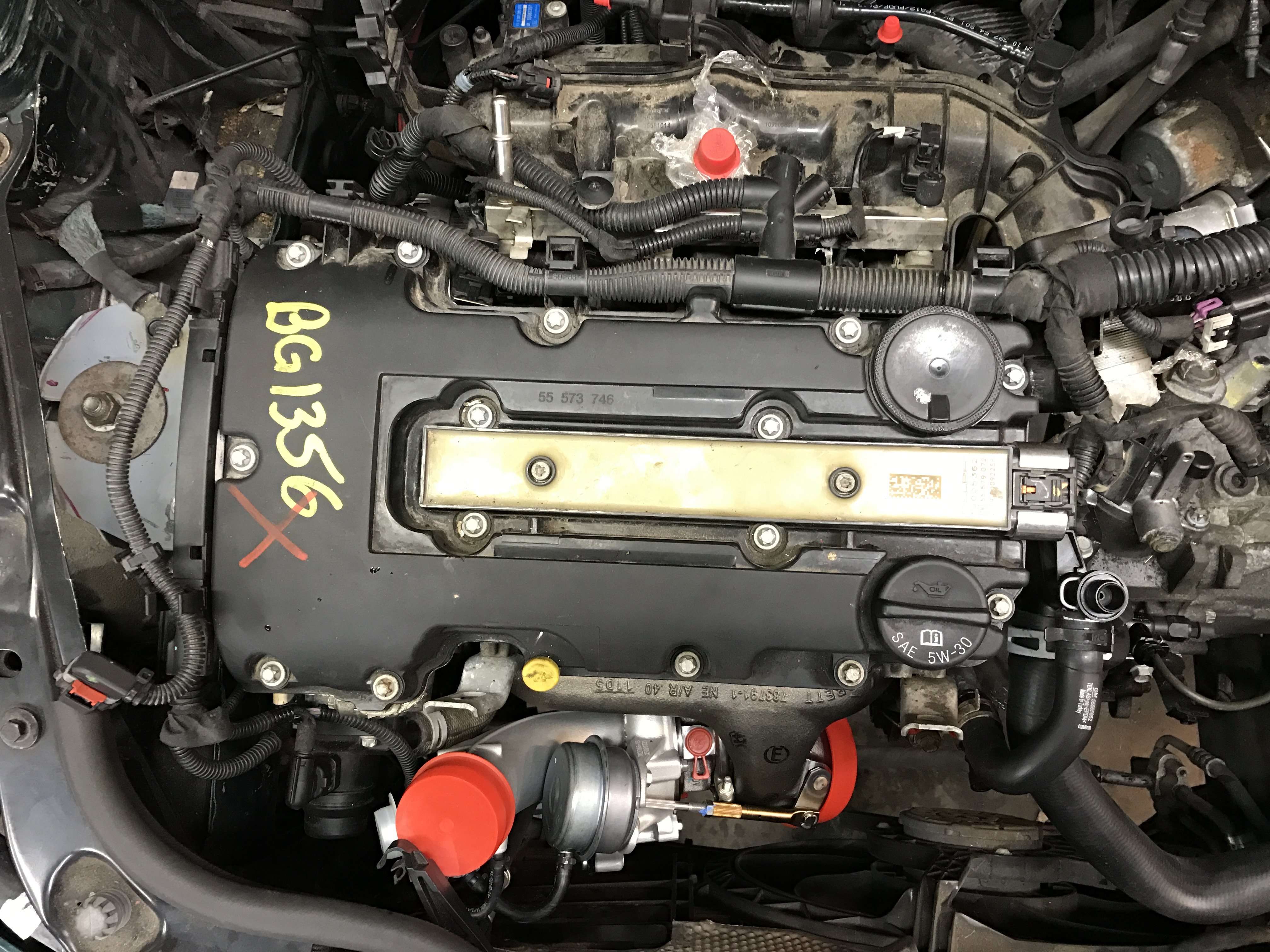

turbo
New turbo

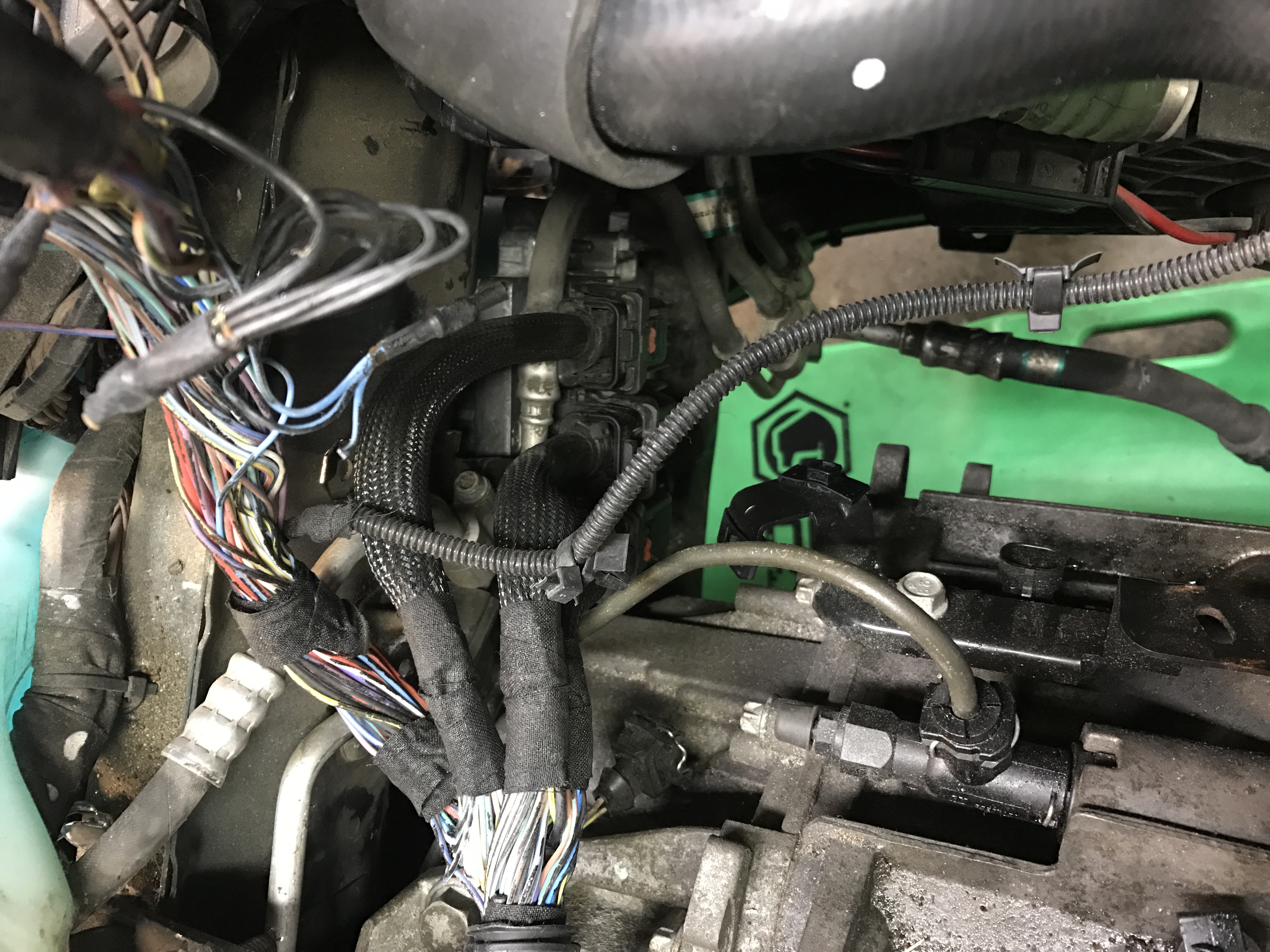

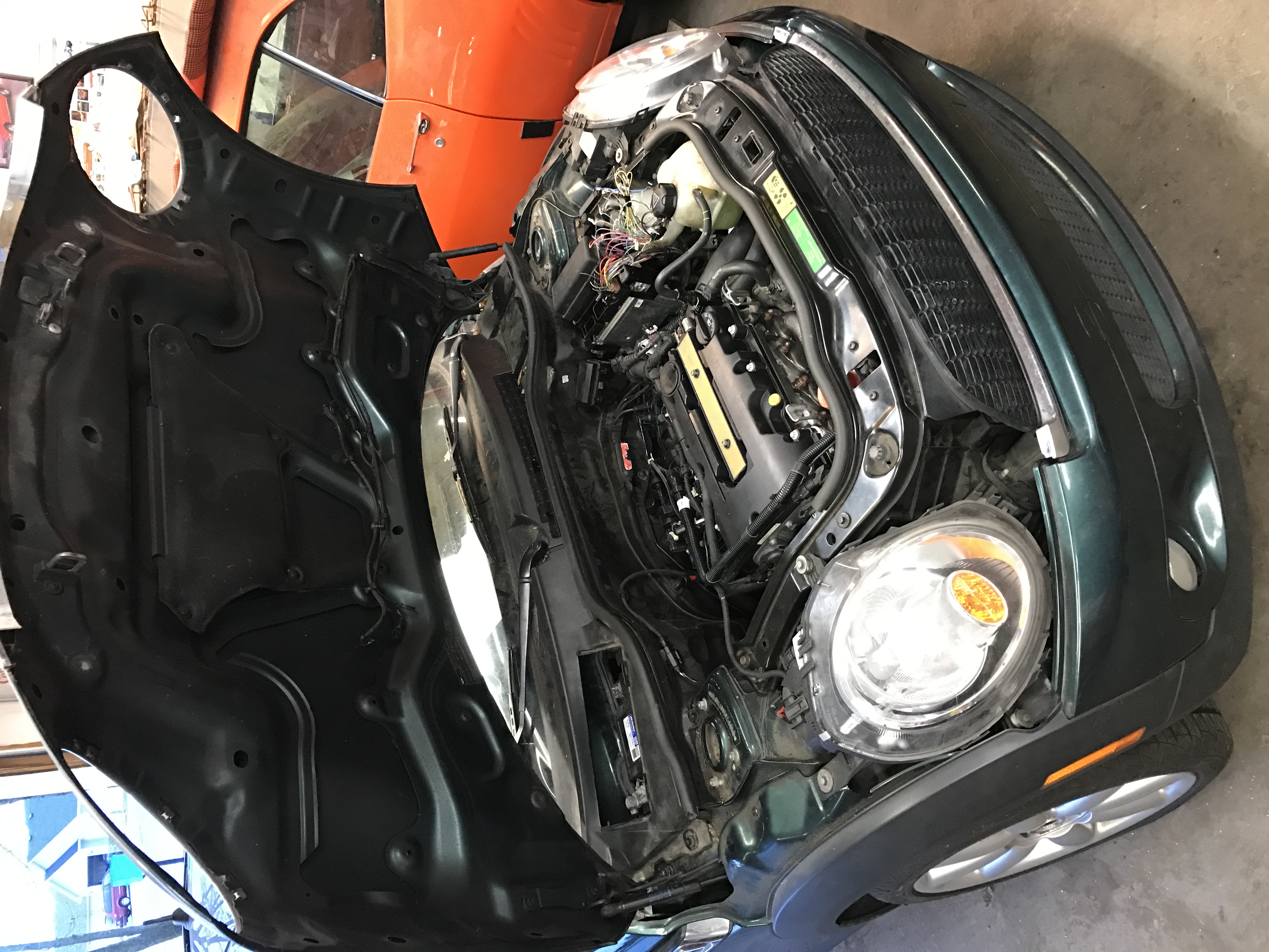

Almost there!
Finally got the new ecm flashed and tuned to eliminate VATS. Throttle is actuating and I now have 5volt references. I just have to run a fuel return line and install a fuel pressure regulator and get the drive axles adapted. The biggest pain of the project was the wiring but I worked through it.
Attached Thumbnails Mini-Cruze 1.4 Turbo-img_3709.jpg   Mini-Cruze 1.4 Turbo-img_3710.jpg
