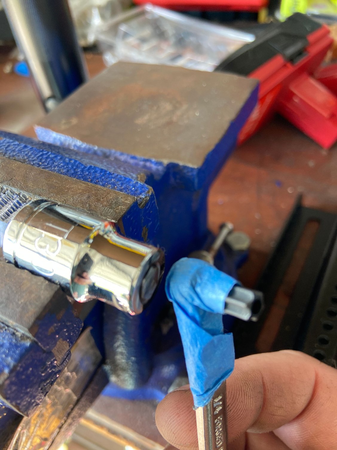

T30 Torx Bit Bolt Fix
Get a T30 Torx Bit. Drimmel cut it as close to the socket possible. Fits perfectly in 1/4" wrench. Tape it to the wrench and it fits
between the subframe and bolt head easily.
